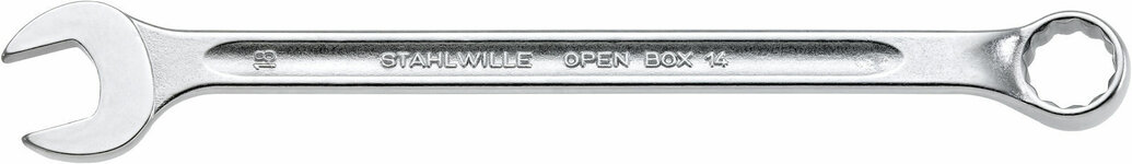

I'm in the market for some combination wrenches. Have tentatively narrowd my choices to these.
I prefer long pattern wrenches. The Wrights seen to be longer than most.
Open to other suggestions too.
I've just sold off some Milwaukee max bites that were too short for my tastes and gripped perhaps a bit TOO well as repositioning was sometime difficult.

If the 14 are like the other Stahlwille wrenches I prefer them for the thinness alone. Not sure of the durability compared to the Wright (I imagine the Wright are stronger) but I'm never putting a ton of torque on a combination wrench.

I’ve had both. I kept the Stahlwille. Thinner, no flaking chrome, more options beyond the Series 14 if you want, and I find the fit is better on the open ends. The Stahlwille stuff is getting pricey though. Even buying via Germany is up there. Personally, I’m more of a Proto and Gedore guy if I had to pick only one or two brands. Proto has the umph when I need it and Gedore wrenches just feel good and unlike my Stahlwille 14s, my Gedore XL are actually long.

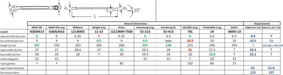

This might help:
Made this years ago when I was curious if "long pattern" was std across the industry. Answer is no. For example: Stahlwile Long pattern aren't as long as Snap On's regular pattern.
The color coding was just my thought process. Generally green is good and red is bad. Note that I noted the Long Gedore wrenches were both good and bad. I believe generally the German wrenches are typically hard tool steel (good) and tend to be thin (good) especially at their open ends. This hurts them in strength test rankings, but helps us with access. Thus the value of charts like this. The Wright Grip, which often wins the strength tests, is a bit thicker wrench and quite a bit shorter than the others. Doesn't make it a bad wrench, obviously. But it would not be the best in my competition.
Now I only compared 13mm wrenches. This being GJ, some argued certain manufacturers wrenches got proportionately longer in upper sizes. Naturally no actual measurements were offered, only that I was completely wrong, and my graphic above was misleading rubish. Thank you GJ.
My personal advice on wrenches - obviously I like longer wrenches. I also like thinner. Note Stahlwile's really small box end. That impresses me and I'll bet I'd appreciate that in use. I'd add to the criteria above (long wrenches, thin ends) rockwell hardness and how tightly the business ends fit from TTC. My guess is, Snap On will win that competition, but I think Stahlwile and Hazet would look more like the top tier wrenches they truly are. Judging from this, Armstrong's long pattern deserves a second look.

Those Stahlwille are good looking wrenches and I'm sure I would be quite happy using them. I agree with Adam that longer wrenches' advantages outweigh the disadvantages most of the time. I forgot I had a pic of a long SO compared to the standard Wright.

Helpful.
In 13mm the differences between manufacturers/models is not huge. In 19mm, it looks like a couple inches of difference, which is significant and most appreciated when torquing big stuff.
