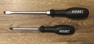

I own some of those drivers.
Oplast are quite a major screwdriver manufacturer, and like any such firm, they offer different grades of tool, as do Hazet.
Yes, the very cheapest Hazet screwdrivers are ”generic” Oplast that have been rebranded. They’re not top end, but neither is the price. I think the last I saw were about €12, for a set of six, so you get what you pay for.
The better grades of screwdriver, such as the “Trinamic” are different entirely, They’re also made in Slovenia, but they’re really quite decent. Hard handles, very decent steel in the blades, very nicely forged and ground, and the design is unique to Hazet
Here are some of mine. They’re nice to use and have proved durable. Are they as good as the previous yellow handled tools? Maybe not, but then little is!78CE664C-E985-47C3-8A73-BB52E38A0C3A.jpeg
