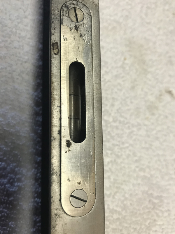

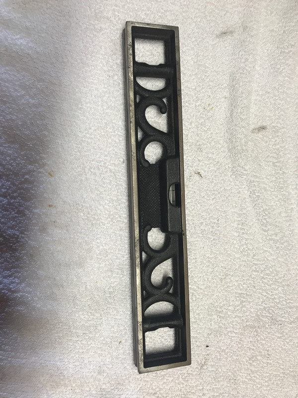

Can I just soak the whole thing in evaporust?

I think that black finish may come off or just part of it will,and what holds vials in place may also desolve come loose but that may be good thing.

Beautiful! Are the vials still intact? Anything made by Starrett is high quality. Should be no problem soaking it in Evaporust. If you have a bad vial I’m sure you could send it to Starrett to have it repaired.

To clean it, I'd start off with toothbrush dampened with WD40 or a light oil and hope most of the enamel (or japanning) is intact.

Well I put it in about 1/4" of evaporust before I left for work 5 hours ago.
Can anyone say for sure if it's ok to dunk the whole thing? I can always do four rotations in the tank to get the flats clean...
Not leaving an item submerged in Evaporust can cause lines or other marks on the object you’re removing rust from.
I’m not sure whether Evaporust has any effect on glass, or whether it might affect putty or other adhesives used to fix the bubble in place.

Well here's one side after 24 hours. Probably have to sit down in good light with q-tips to get the vials good and clean. Toothbrush and wd40 helps but not getting in there all the way.

I use EVAPORUST often. I would suggest wetting some shop cloths and placing them over the rusted areas. If you are concerned about the shop cloths drying out, you could set the level, with the shop cloths in a container with about a centimeter of Evaporust in the bottom The liquid will be wicked up into the cloth.

I use Evapo-rust everyday. There's always a batch going on. I dunk old vials on those levels and combination squares etc.... the only way evapo-rust would get in is if that vial is no good in the first place. Some of them are glued in and the evapo-rust does not damage the glue.
When I paint those levels, (if using spray paint),I use Vaseline on manicure/pedicure Q-Tips.... Rub Vaseline on the vial, paint, dry, wipe off Vaseline.... Too hard to get masking tape in there.
Oh yea, evapo-rust will clean vial, but clean it with alcohol and Q-Tip prior to Vaseline.
Also, 1982fxr, I see you've been using evapo-rust a lot more lately. You can dilute it quite a bit btw, and it still works.
What I do example: all metal tilting mill table I just did. It had decent rust going on, but still a user. I degrease big stuff out in lawn, then put in ultrasonic with purple power for a day (soak 23.5 hours,run machine for last .5 hour).... That alone removes most of the rust. Then I take it outside and hose it off really good. Then I put it in evapo-rust to fine-tune it and get it perfect. That way I'm not using up all my expensive evapo-rust.
On big heavy ugly stuff like a big vise that's really rusty I do citric acid powder mixed with water and a big sterilite container. That removes all the rust...but it will flash rust. So I hose it off. And then I will put it in evapo rust because it seals it.

Thanks Mohawk. I think I'm going to completely dunk it then because these vials are dirty and hard to see.
I tried the wet tag method mentioned in another post but it didn't work. I live in Phoenix though.

One more thing... Evapo-rust will stay kind of sticky, so I hose off or if it fits, kitchen sink with hot water to rinse, then blow dry with compressed air.... At that point it's ready for either paint/primer or get oiled down with your favorite fluid (I usually use Marvel Mystery Oil for most bare metal stuff in my shop)
Evapo-rust does have a detergent in it, so it's pretty damn good at cleaning, not only de-rusting. It should clean that vial as good as anything else.
I've done that wet paper towel laid over big stuff before.. its slow and needs repeated... Works better on flat stuff of course.
My buddy just used spray on Krud Kutter Rust Remover.... That stuff actually worked pretty damn good. I'm going to grab a bottle next time I'm at HD.
Mohawk Dave
Oct 7, 2012
5,068
SoCal
And I'm sure you've noticed, if you leave some stuff in too long it gets real black by pulling the carbon of the metal to the surface. Very seldom does it take more than a couple hours for most stuff... After it's gone through my ultrasonic it usually takes 30 to 60 minutes in evapo-rust.
I keep some green and maroon scotch Brite near the evapo-rust station... As it's soaking I'll pull out the item and lightly assist with knocking off the rust with scotch Brite.
