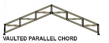

If you went with a vaulted parallel chord truss (steel or wood) ...
... you could put the garage doors on the non-gable sides. The garage door tracks would run up parallel to the bottom chord.
