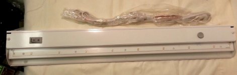

Wasn't happy with the visibility inside the toolbox so I picked up a 24" under-cabinet dimmable LED light fixture at HD. Didn't really need the dimming feature but this unt had a really high lumen output and that's what I wanted. Using some aluminum angle stock and some threaded rod that was laying around I fabricated and painted a little doohickey to hold the light fixture in place. On full bright this unit puts out 800+ lumens so visibility inside the drawers is no longer a problem.
Using some 2x2x1/8 aluminum angle and some threaded rod, I made this for my tool box.
I used this light fixture specifically because it's super-bright pumping out 812 lumens, and it's got full range dimming.
GE 24 in. Linkable LED Under Cabinet Light Fixture with Full Range Dimming
At HD - Model # 10449 Internet # 204663926 Store SKU # 1000024625
•8 non-replaceable LEDs
•24 in. fixture length
•812 Lumens
•Plug in and linkable
http://www.homedepot.com/p/GE-24-in...xture-with-Full-Range-Dimming-10449/204663926

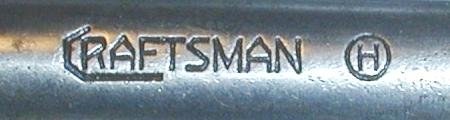

Some tool drawers shots...
I've collected up a number of Craftsman chrome sockets:

Hey just wanted to say your garage looks great. I am doing the exact same thing only on a bit smaller scale (only one workbench). Would you mind taking a measurement to let me know how high off the floor the backwall sits while installed on the work bench? I am not putting together all my stuff until I do the floors this spring but wanted to hang some VersaTrack and the wall mounted cabinets. If you wouldn't mind also measuring how high off the floor your VersaTrack is (to the top of the track from the floor) I would really appreciate it!! Looks like you got it perfect as your cabinet sits just off the top of the backwall.
That was tricky. From the high end got 91" from floor to bottom of VersaTrack that the cabinets are hanging on. The work-bench on the high end (left end)has the leg levelers screwed all the way up. I advise NOT to mount the VersaTrack without first having assembled the work-bench with back-wall, leveled the table, and then test fit.
Reasons:
1. Residential concrete floors can be wildly out-of-level. (Frickin' concrete finishers :mad:) Mine appears to be more than 1" out of level in the 12' run of the table. So if I had measured up from the floor to place the VersaTrack and I had picked the low end to measure from I would have been screwed.
You could use a laser and yard-stick to figure out your floor's levelness and measure up 91" from the highest end.
2. The lights are attached to the underside of the back-wall hood with tiny acorn nuts that stick up about 1/4".
