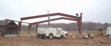

sberry
Jun 18, 2005
35,747
Brethren, Michigan
The crossover may be higher than 1500 but a lot of it certainly depends on the interior finish, height.
