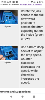

Is it that bad? I have had the 20 for over 15 years never an issue from the start except, I had to get used to how fast it can lower and learned how to use it to lower the load slower.
Did you see the link where you can adjust the lowering speed?
This is for the 13, but the 20 may be the same unit.
