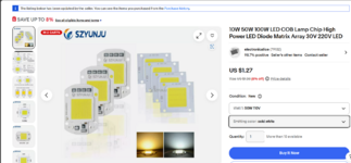

Seems like this is a case of you get what you pay for.
For $1.27 you get the ones that failed quality controls but still light up.
Please be 100% sure you ground the fixture you mount this LED in as the driver circuit most likely has no isolation from the mains power making point of this LED have 170 VDC to the ground.

I've been purchasing from these guys for some time and I'd never had an issue like this so I don't know I buy that TBH. With that said, the 20W that was also hot was from a batch well before my 50W batch I got last year so these may run a bit hot which I know can impact their life but most of these have been fine. It could be possible that I did get a bad batch and that is where I'm starting to go. In my head the location won't matter as it's the same circuit, but I did take the fixture that's been fine and moved it to the position the problem child was. Right now, I have the problem child on my bench. Each fixture is 100% grounded to the box.

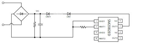

So I did get a # off one of the CC LED driver chips and it's an SM2082ED. It seems it has a .6 ref voltage and to calculate the current you would divide .6 by the desired current. GIven I have 4OHM resistors for each chip this is driving the LEDs at 150mA! AFAIK these are all in series. As a proof of concept, I removed the 4 ohm resistors and threw in some 15 ohm through hole (I have no SMD resistors currently). Don't laugh at the ugliness but it proved my theory. I'm drawing a total of 135 mA total now with 15 ohm resistors which "should" be driving the LED string at 40mA which is still higher than I want but the temp center COB is 78C and steady. I can deal w/ the brightness at that current draw but I may throw in some 30 ohm resistors to see how bright it is at a more reasonable current.
