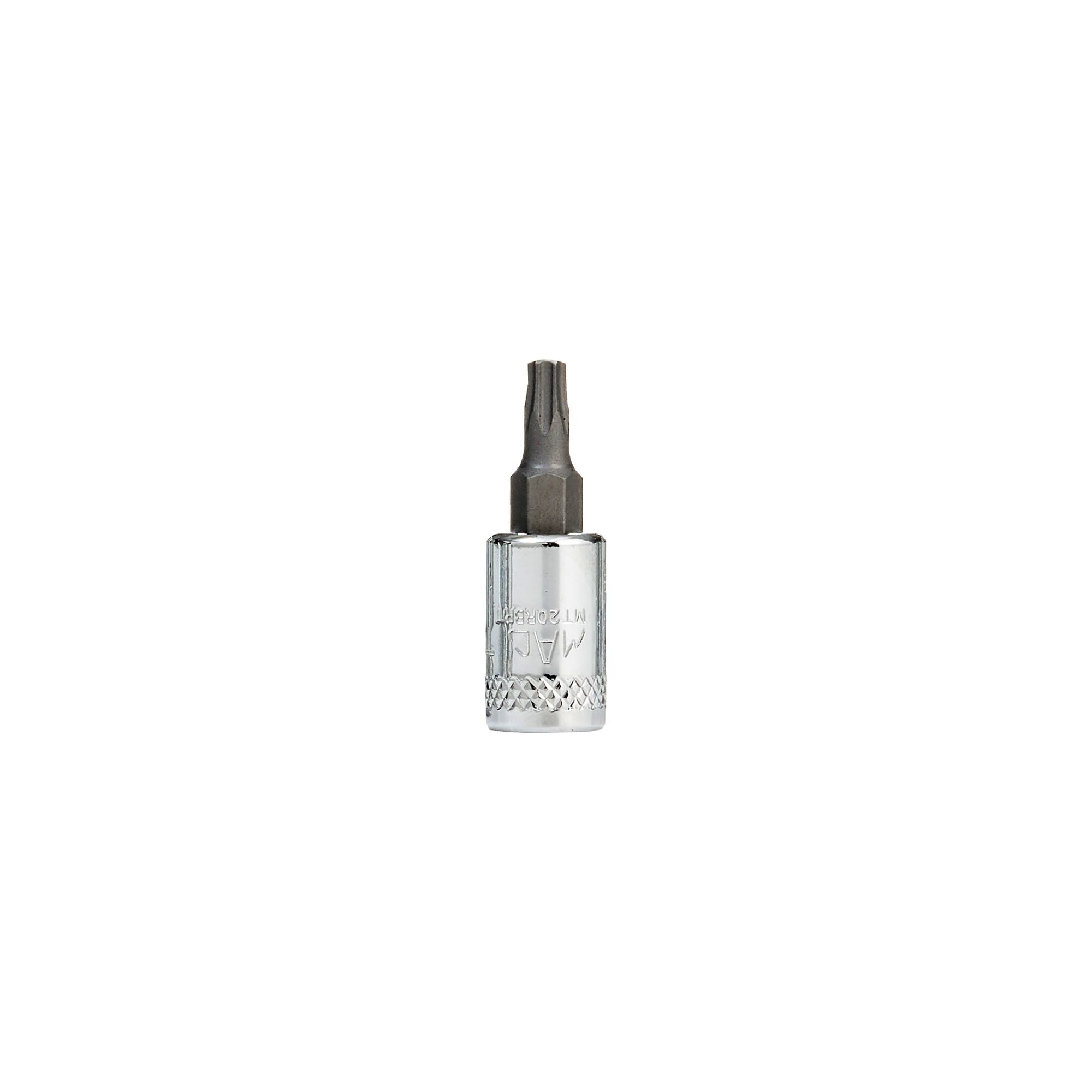

stripped T20 torx cap screw
sqznby
Oct 26, 2013
993
Coastal NC
I don't typically post this kind of stuff, I'm stubborn when it comes to asking for help.
I need a little help :)
I guess Google 09 Dodge Charger ABS module replacement for an idea of what is going on.
Here is a smorgasbord of pictures to see what I'm dealing with and the culprit. And of course, it's the last cap screw that has be give me trouble.
The only tool that will fit is a 2" t20 torx bit with a 1/4" ratcheting wrench. I may be able to get my M12 right-angle drill in there if I have but that is my last resort.
I found a way to hold the bit in place and tap it with a piece of brass. Doesn't help.
I'm hoping someone has some info about extractors or really anything at this point to remove it.
Has anyone hav luck with a reverse drill bit extractor?
Any and all info would be much appreciated.
If anyone asks why not send it to a mechanic, I said I was stubborn :) and I don't want to fork out the $1200 beans I was quoted. Parts & Labor and that's from my local guy I have relied on for 7 years.
I try to do as much to my vehicles as I can while I'm vertical oh and did I say I was stubborn.
Thanks everyone

Are you replacing it? Can you get a dremel cutoff or hacksaw blade between the module and mount to cut the screw get the remaining piece out later?
Even if you can't get it out, three outta four holding the new on on aint bad!
Hack-mechanic over and out.
S
sqznby
Oct 26, 2013
993
Coastal NC
I am replacing it and I have not removed the old one yet :(
Unfortunately, there is no room for anything to reach the head of the bolt. If you zoom in on the second picture you can see where I have to get to. Not the most convenient location. Why couldn't the top side strip instead haha.
The only bit that fits is a T20 torx bit which is very thin. A 1/4" driver bit will not fit to engage inside the head, it's too fat.

I think you're going to have to drill the head off or break the brake lines and take the whole thing out. That's all I got.

The tension is held by the head.
Unless it's seized from rust, which doesn't appear to be the case, all you need to do is undermine it.
Long chisel. Dremel. Get something under it and break it loose that way. Should just turn out, maybe with some spray

Those look like 1/4” bit drive? If so, put a bit extension on one and you have your 2” length.
Yes you are correct but the 2" long has a narrow shaft and head that fits the T20 bit size. It narrows down when it gets closer to the head of the screw so a standard 1/4 size bit will fit nor will an extension. It's pretty precarious location and position because of the lack of space and accessibility.

I used to work on similar ABS modules on GM trucks if You can, grind the head off using a carbide burr in an a die grinder it will relieve the tension on the screw . If You are replacing the computer module part anyway, it will not matter if you knick it while grinding the screw head off. After grinding the head off, slide the module off and remove the screw with needle nose pliers

I used to work on similar ABS modules on GM trucks if You an grind the head off using a carbide burr in an a die grinder it will relieve the tension on the head. If You are replacing the computer module part anyway, it will not matter if you knick it while grinding the screw head off. After grinding the head off, slide the module off and remove the screw with needle nose pliers
That is more than likely what I am going to do if I can access it with a die grinder. If not I have a pencil attachment for a Dremel but I don't have a Dremel haha. I'll go grab one tomorrow and just.

I recently needed to remove a fuel rail on my 21 Harley. I had no room to get a T30 in there. I had to get a 1/4” driveT30 bit and cut it to lenght. It was a beeeatch to get it out but I got it done. I had to insert it in with a needle nose plier and turn it with a small wrench. It didn’t have room for a gear wrench. Open end only. Took much patience.

I can't tell from the pics how damaged the head of that is. If the head of the bolt is gone, can you remove the item and then get vise grips on the now headless bolt? If so, that would be my first choice - remove the head of the bolt - chisel, grinder, etc. My second choice, if there is any "tooth" left to that head, first soak the bolt in Kroil, then, after a period of soaking, clean the head with a shot of brake clean, then use some JB Weld to epoxy the appropriate driver bit into the bolt, after it cures for at least 12 hours, apply a wrench.
The head was damaged enough to spin the t20 bit inside of it, it wouldn't engage at all.
Huh, never really thought about the JB Weld idea, that's actually a really good idea if it would hold.

So, end result was to take a shorty 1/4 drill bit and drill the head out then followed with a larger shorty 3/8" bit at whatever angle I could fit it in there because the 1/4" bit walked on me and left half the head, yay.
End result was what seems to be a seized screw, b***h didn't want to move that's for sure. They are both in the same orientation.
It took a few more squirts of Houdini a tap with a brass bar and then about 37 turns with my smallest pair of vise grips, and it finally came out.
I chased the hole with another screw and the amount of junk that came out of the hole was pretty shocking. I may throw a dab of anti-seize on there just for good measure "just in case" I have to do this again haha.
