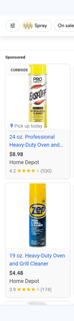

Just a bit of information. I've found two different types of oven cleaner. Low fume/odor and the good stuff, like Easy Off Heavy Duty. IMO, the low fume/odor stuff doesn't have much strength. Get the good stuff, avoid anything that says low fume or odor like the plague.
Worth repeating again...
I typically get the easy off oven and grill PRO at home depot, looks like it went up. Might try the zep, all their other products have typically worked well
