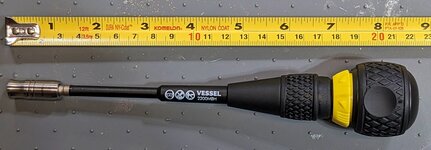

So the end of the stubby (TD-6700) is not the same as the full size? (TD-6800) that is disappointing as I am growing to like the latter.
Nope. I have them both and they are both nice drivers. Their ratcheting mechanisms and lockups are fantastic. But the stubby has a double ended bit with a ball detent instead of the regular bits and magnet that the full size version has.
well crappit, can someone who speaks Japanese get on the phone to the Vessel product development people...?

I just picked up another Vessel ratcheting driver. I gotta stay out of these threads!
Built-in stubby.
F-22
Jan 23, 2022
1,830
Built-in stubby.
I've wondered about these a few times. They accept 1/4" bits but the proprietary bits with half of the handle look really nifty.
I guess that these have a lot more contact surface along the "shank" so they don't wobble much? And since you can grip by the bit-handle, it essentially has zero play when you're fine adjusting stuff?
