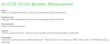

The main panel in my garage (SD QO) feeds a sub panel in my basement via a 125A (Q12125) breaker that looks like this:
I need to add a 220 circuit for a planer but the main panel is completely full. Is there any reason that I can't replace this old behemoth with a standard 125A breaker that only takes 2 slots instead of 4? Any idea why this would need 4 slots? It being 220, it already contacts both bus bars. What is the advantage of bridging both sides of the box?

See if you can find a label inside the panel indicating what style of cb and amperage limits there are. Yes there are 2 pole 125 a QO cb's that take only 2 slots. They are $$$. Another option is lowering down to a 2 pole 100a cb for about 1/2 the price of the 125a.
The reason why this cb connects to 4 buss stabs is that either the cb connecting hardware couldn't handle the 125a alone or the buss stabs couldn't or a combination of the 2.
Someone can probably tell you the history of QO's about evolving from 4 stab to 2 stab versions.
Also check the replacement cb can handle the wire size of your feeder.

The CB you have is of a Q1 series cb - label indicates that. Q1s are obsolete. QOs replace them now apparently.
Does the label inside your panel indicate "NQO" panelboard?

Thanks for the info, mm. The label on the inside of the door lists it as a QOC20MW225, if that helps. I'm tempted to go the 100A breaker route as the subpanel that it feeds served quite a few 220 appliances (WH, oven, dryer, 4 baseboard heaters) that have been removed and/or converted to gas so the actual load is a lot less than it was originally.

I believe that part number is for the cover only.
In the panel back box there might be a label with something similar to "QON20-40MW200-1 Series L8". Unless a label detail indicates otherwise, I'd assume the QO2100 is permitted based upon the above screenshots from SQ D.

I found the tag on the inside of the panel. It reads QOB30MW200 Series L8. Google doesn't have much information for that model number.
