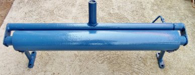

A couple more projects.
A sheet metal roller. I got tired of looking at that rusty hulk, so one day I cleaned it up a bit and painted it with Tremclad dark blue (same family as Rust- oleum), much the same colour you find on Record vises. Minimal preparation was done, just a quick once over with #80 sandpaper then paint with a brush.
https://www.tscstores.com/TREMCLAD-RUST-PAINT-DARK-BLUE-378L-P6263.aspx
The other, a dust pan. There is some peeling on the handle, probably because it is galvanized. The rest, on the body is due to wear and tear.
The sheet metal roller is for making uniform curves on projects, rather than "kink bending" on a brake as the method I so often see used. Even Mr. Pete did that on a lathe belt guard he was making.
