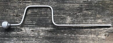

1/4” drive Chrome plated hinge handle with some military provenance. DB871DB8E4-F596-4FD8-B769-E4C170136421.jpeg
Chrome plated 1/4” drive speeder DC791B13C8-1135-4D2E-9D0A-65A503899B80.jpegF29512B7-B77B-4C3F-8B6E-0E8E40ADD93D.jpeg

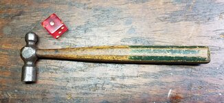

Is that busted ignition wrench chrome plated?
Yes. Pretty sure. It can be hard to tell the difference between highly polished steel and chrome sometimes, and also between a really well done and well-preserved cad and dull chrome sometimes, but I am pretty confident on that one.
How sure are you about the 1222 combo, the 5261 extension, and the 5463 extension? Most of yours, like mine, are very unmistakably chromed, tight and shiny, even from here. Those look a little duller, even satin-y to me, though. Reason I ask goes back to my near-disaster story with my 1/2-drive Pebble set. As you may recall, I found it totally fuzzed in rust, box and tools. As you may recall, I assumed it was chromed. As you may recall, I had a terrible fright when I checked on it in the Evaporust bin after an hour or so and discovered it was not. It looks great, like a nice natural steel set, but it's not. See Pic 3 where I am un-hiding the bottom of the hinge handle. That splotchy "grey" revealing the steel underneath is the finish that is on everything, including the sockets.
We know about plain steel, cad, and whatever that phosphate is, probably zinc, that they used. But there are Plomb finishes, sometimes identified as "thin" chrome, that look almost like paint. Not saying it's paint. But it's not chrome. I have seen other examples since my near-disaster.

If I ID a tool as chrome plated, it’s because there is sufficient evidence. Not all of my chrome plated tools are perfect and shiny. Lots have chrome peel and worn surfaces. Will you be asking other contributors if they are certain of their evaluations? I’ve been spending some time going through my pictures that I could use for other tasks. I’ve tried not to let my opinion of the theory slant the pictures I’ve sent in. When I checked the Wayback Machine to look at Todd’s examples, it was obvious that they were all from his personal collection which wasn’t all that large of a sample size.
