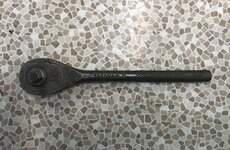

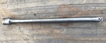

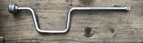

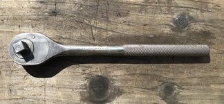

16,591
I checked 16 1/4“ drive ratchets this morning and every one of them has the two letter code ending in C. I’m interested in knowing if there are examples out there that don’t have the code letters. Here is the ratchet from my Plomb based GMTK. GC
1/4” drive flex handle dark finish badly stamped probably AC4CE70D3C-8AE0-4BC8-A7C3-18D2DBAD610F.jpeg
Dark finish 1/4” drive extension AC5D7ACE74-32C1-4E0E-80B6-9712A62E659C.jpeg

1/4” drive plain finish 1/4” socket BC9B3A3AF1-E8C2-419C-B50F-B435CC593D1C.jpeg
1/4” drive plain finish 3/16” socket FCA70A5784-8DF0-4248-A203-204B0FAF8BAB.jpeg

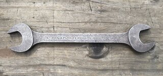

Dark finish DOE wrench 1” x 15/16” DC47463624-D927-4056-AC3B-0C4703EBF7F2.jpeg

16,591
More pictures.
1120 War Finish 3/8” x 5/16 CC
1122 plain finish DBE 7/16” x 3/8” BC
1125 War finish DBE 1/2” x 7/16” FCF5CBCC8E-2F66-4CCC-A7BE-3CA37E1AE0FA.jpeg
1220 5/8” combos plain finish DC & JC
1216 1/2” combo plain finish KCF49F7866-7BA9-4590-A27E-03D1C334EE95.jpeg
