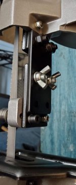

I'm still waiting on the SWAG table, so today's project was to copy slednut's blade guide extension. Since my saw is a Bauer, I had to adapt his idea. I used materials I had on hand, I just had to run to the hardware store for a few pieces of metric hardware.
Mine is made from 3/16" x 1.5" steel bar. It has just two positions - high (shown) and low. In high the throat is about 1.200", low it is about .200". If I need to cut anything larger, I'll just put the guide back in the stock position.
It's not perfect, but it came out well and it seems to work fine. Thanks slednut!
