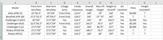

How important do you guys find it is to have 3 stage arms front and back? I know a lot of people make due with 2 stage arms, but I'm just curious. Many lifts I'm looking at are 3 stage front, 2 stage rear. I'm assuming it just helps in terms of short wheelbase vehicles?
S
SlickXJ
Jan 5, 2018
20
Sault Ste Marie, Ontario
I have narrowed it down to these lifts. I'm still waiting on pricing from local distributors for a few models, in which time I'll make my decision. I think the one I'm the most interested in is the SPO10-RA, but that might change once I get a price.
Keep in mind all pricing is in CAD, so deduct about 20% if you're curious what it comes to in USD.
Makes a huge difference with three stage front and rear. Shortor Long you hit where you want with ease. Allows you to rack a lot of cars asymmetrically on it for door opening. I work on 3/4-550 chassis trucks daily with some cars thrown in, wouldn’t have it any other way! For the long trucks it’s the best. Had a f450 with a midmount knuckle boom crane on it, and next to it on identical rack I had an 88 Suzuki samauri. So versatile it’s rediculous

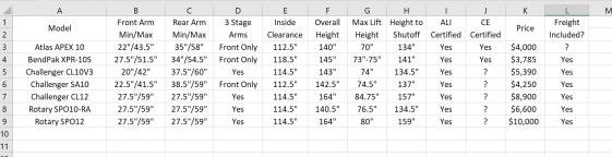

I am really currently leaning towards the BendPak XPR-10TS, as long as its quote isn't much more expensive than the quote I got for the XPR-10S, which was a little under $4,300 after tax and freight.
I attached my updated list of lifts with more pricing information if anyone was curious as to quotes I got. Again, prices are CAD.
Man that seems high .
