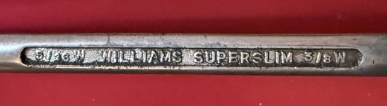

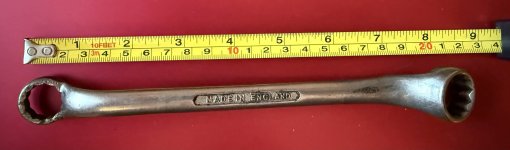

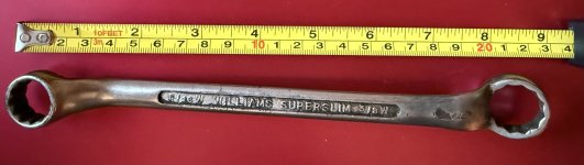

A DBE Williams Superslim Wrench 5/16W x 3/8 W . Made in England. 8 3/4” long.
