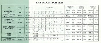

That's a nice original set of wrenches you have Jim. They match the advertisement for them right at the beginning of this thread. A few years ago it was easy to find full sets like that for sale but they are getting more rare and expensive lately.
Like you, I always thought "these things are not very 'slim'.." They go well with your MG, and would very likely be in or an addition to a tool kit of that era. That is an exceptionally smart MG car, what fun it must be! :thumbup:

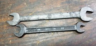

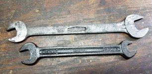

Here's the aforementioned "[JAGUAR]" wrench. Any idea when it was made?
Compared to the SUPERSLIM, what with the panel and the black finish and the Whitworth and BSF hardware sizes turned sideways on the shank, it's a rather plain jane.
Both wrenches are unfortunately afflicted with box rot stains and some pitting.

Lugz,
To the best of my knowledge, which isn't great, that 'Jaguar' wrench is older than the 'Superslim' pattern ones. Maybe 1950's? Maybe someone will know for sure.
The 3/4"x 7/8" short series Superslim ones can be quite expensive as they're compatible with later Jag. tool kits I have seen them listed around £30 but luckily I managed to buy one for a small fraction of that after looking for a long time.
A lack of catalogues and no date codes on the tools makes dating difficult, as you well know!

Here's the metric spanner clip set i posted over in the other thread. I think they were lightly used if at all!
That's a nice set JjK. I remember them being sold in boxes like that but rarely seen recently not many boxes have survived at all and not in that condition.
The metric sets were either 6 or seven piece, that 7 piece 'scooter set' included the smallest 6 and 7mm spanner.
I see yours have a small letter on the casting, looks like a letter 'M' ? These seem to vary and i suspect were when dies wore out or something and not date codes.
A question. Are these small letters all the same on all the spanners in your set? So few original sets survive it's hard to find out a pattern in them.

Here's the advertisement and the 1965 catalogue contents listing for the various sets, which I posted up thread somewhere:

My set has a variety and they are Y, B, and W forge marks. Hard to see in the pics. Different dies then I guess?
