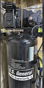

what you think about these two models below:
Model 1 - US general , seller asking 475US
Model #2
Campbell Hauser Farmhand 60 gallon air compressor 3.2 HP Twin cylinder, asking price 620usd

That is a single-stage aluminum pump. There was nothing special about it. I'm pretty sure that IR stopped making replacement parts and compressors for that model. I'd move along and find something else, especially for the price.
The t21 and the rand 4000 models pictured above are NOT single stage pumps and both of them are better than the other two above. as for parts that pump was used for at least 35 years.
