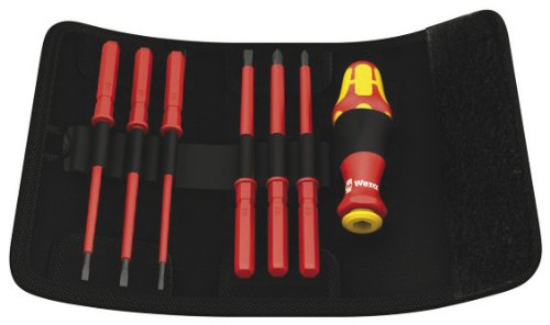

i have the wera multi-blade kit, covers most of my needs for screwdrivers and i don tneed to carry a ton. the whole pouch and blades weigh less than one of my chiseldrivers also, so no extra weight to worry about.
i'm happy with it, has sizes small enough to get to the really small terminals on freq drives, and blades big enough to grip large terminal screws
