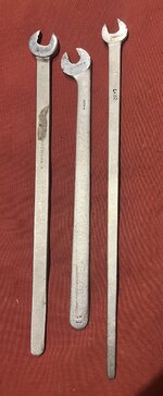

TA16 isn’t identified on the tool.
I’ll have to be on the lookout for one with the plunger not stuck or attempt to unstick mine.

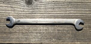

A few recent “as found” examples in pretty good shape. Need only a good cleaning and a new home.

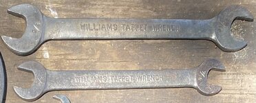

Picked up two Williams Tappet Wrenches this morning, mostly because I was looking through this thread last night. They seem older than some others posted.

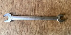

Tripped over these single end tappet wrenches this weekend. Bonney L402, Bonney 1601A and what I presume to be a Blue Point XL189 from 1948. Sadly looks like the makers mark was ground off for some reason.

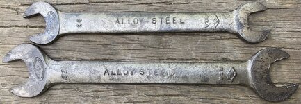

Here are two British military surplus tappet spanners/wrenches. One by Snail Brand and the other by Athol. The Snail Brand is crudely finished and dated 1953. The Athol 5/8 x 9/16 is better made with the faces of the jaws nicely ground and dated 1954. Both are 9 1/2" long.
I got both spanners in a job lot at auction 30+ years ago, both never having been used.DSCF9631R.jpg
