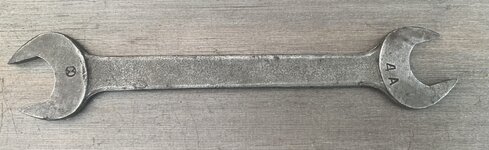

LANE IRON WORKS is a company I'd never heard of before finding this wrench. They were located in Brooklyn N.Y.. Google turned up several of them on ePay and they're all the same size as this, except for one that's the next size smaller.
I believe this Duro Chrome tappet belonged to the same person. I'm glad they didn't push any harder when using their engraver-pen to initial them.
I read that they were included in the Jeep tool kit, but won't actually believe it until Don or Greg confirm it. :)

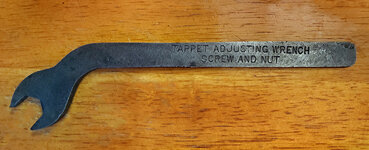

Found another one of these eponymous self-proclaiming wrenches at the flea market this morning. Between an earlier find, and a gift from a GJ friend, that makes three.
leg17
Aug 11, 2011
1,374
Kentucky
As discussed previously, you have examples from two different stamping dies and corresponding different text stamping detail.
(The one in the middle was actually stamped upside down from the view shown)
Two different suppliers for one agent or two competing companies??
Intended application??
Still have all the questions.
