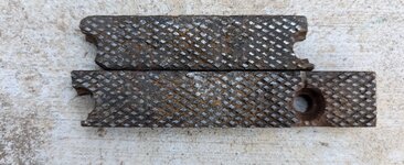

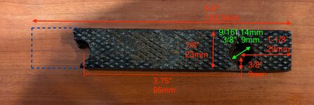

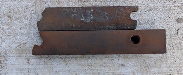

I just picked up a Taskmaster-6 for nearly free. The catch: it clearly needs new jaws.
Any ideas where to find jaws? They are 6 x 7/8 x 1/2 (not unusual), but the screw holes are approx 1/16" off-center and 3-3/4" apart. I can't find a source jaws of this configuration.
Unfortunately, most sources don't show the hole location dimensions (or any dimensions at all).
Or, maybe I should drill and tap new mounting holes for common jaws?

Why is it so hard to find dimensions and mounting hole location data for jaw inserts? I can't imagine I'm the only person to need replacements for an off-label purpose. (BTW, I started a list of the inserts and specs I found and intend to post it.)
Anyway, happy to report, I found an inexpensive pair of 6-1/2" x 1" x 5/8". Those dimensions are a little larger than original, but workable. Very important... the mounting holes are only 2-3/8" C2C. That's significantly inside the originals (3-3/4"), so I can drill & tap new holes in the jaws for them. I think this will work out just fine.
If I had a mill (but I dont), I'd take 1/8" off the mounting face to true it up, and better fit the new insert thickness. I may cut off the 1/4" extra insert length on each side with an abrasive disc. We'll see. But overall, I'm very pleased with this compromise fit.

Just to close out this thread (as far as my jaw insert retro-mod).
I drilled and tapped for the new jaw inserts. I'm an ignorant amateur with machining and now realize I could have done better ensuring the location of the pilot holes. I have a good enough drill press. But, securing the inconvenient shape of the vise base and jaw is ... difficult. And, even though I made center punch divots, I think the bit wandered. The alignment is not perfect. It's not bad, and plenty good for me.
Regarding drilling, I'm glad I have a bucket of old bits. Not knowing what metal composition this vise casting is made of, I used my sacrificial bits. It sure felt like I encountered 3 different layers. Each drill depth started slow, then eased up, then hit a wall. And, the shavings were always more like filings than drill shavings. (That's all warning/info if anyone does similar mod).

That looks pretty good. Those chips are normal for cast iron. You could easily cut the ends of the new jaws flush with a hack saw or cut off wheel. Then file or grind smooth. Whats next, full paint job?
