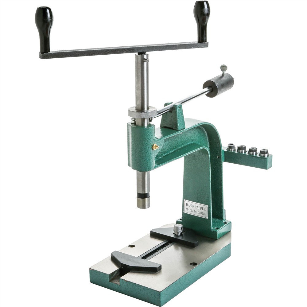

At a minimum get one of these to help you keep it perpendicular to the surface.

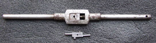

The first step in successful hand tapping is to use a size of tap holder that is appropriate for the size of tap being used. Using a tap handle that is too large gives too much potential for breaking the tap if its not perfectly aligned with the hole due to the amount of leverage available. Also, as has already been mentioned, if you use a holder that is too big/heavy, you loose some feel of what the tap is doing.
I have probably 10 or more different sizes of tap holder, which may be slight overkill in the best GJ tradition.
The long one below is 14 1/2" and the small one is 2 1/2".
