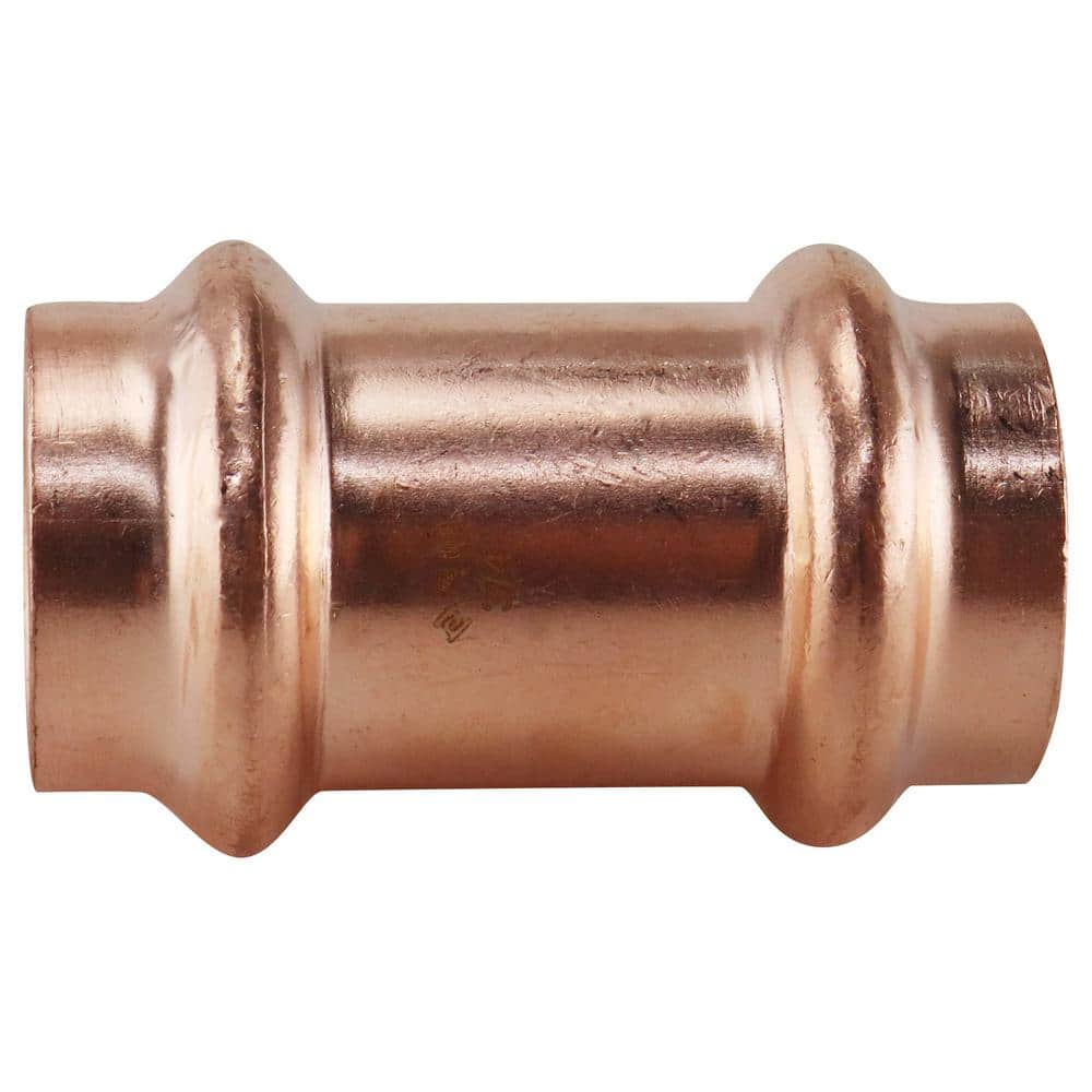

My first thought would be to cut out about a 4" section of the 3/4" copper. Than get a regular copper T and solder in two 'legs' in the straight part so that it would be a good fit to the missing section. Than you get a couple of these slip unions. They don't have 'stop' in the middle, so you just slide them on the existing pipe, insert your T section, slide the unions back over and solder in place.
Zeke
Aug 13, 2009
17,176
I think if you can get down in the hole enough to clean the pipe and wrench a fitting, you can use the slip solder unions mentioned above. The only problem might be evacuating all the water to solder. I know there are products, but you have a limited amount of time to get your joint soldered.

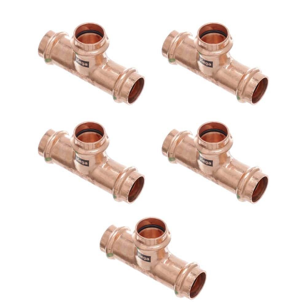

If you can rent a propress tool, that might be an option.
There's also saddle tees for copper, but they are pricey.
fitter30
Jun 23, 2019
2,990
Peace Valley,mo
Propress and other brands are below grade approved like viega. If it has to be inspected check with local plumbing inspector. There is no soldering but need the tool for crimping. Don't know if the tool it can be rented. If everything is ready to crimp only takes a few minutes and water can be dripping. I've crimped full port valves on with water on a had no problems other than a bath. The other way is a pipe freeze kit with two heads stops the water dripping makes it easier to solder.
