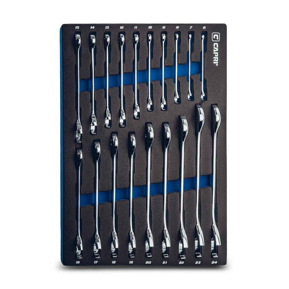

What about the Capri angle wrenches? I didn't know they made them till a few weeks ago. I don't own a single Capri tool so I couldn't say what quality would be like but they could be another option at least.
Anybody here have any experience with them?
I own and like the Capri 3/8 flex head ratchet. I’d look at their combination wrenches if I needed a set. The angle wrenches I’ve seen from them are 15/60 and that’s a non starter for me.
They must have updated to a new style like Tekton did then. The sets on the Capri website are a 60/30 and have an 'anti slip groove' style open end. Kinda reminds me of my Proto ASD wrenches.

Here's the Home Depot link, I forgot you said you had gift cards for there.
It is a 6-24 mm set instead of the Tektons 10-27mm though. I'm not sure what line of work you are in but for me (auto mechanic) the smaller ones in the Capri set would be used a million times more than the bigger ones in the Tekton set.
I was going to get the Tektons but I'm almost talking myself into getting the Capris instead :lol:. The metric set anyway....SAE I will need to go Tekton to get the bigger sizes for hydraulic lines on tractors/equipment.

Wow they do! Thanks! Never heard of them though, are they china or Taiwan? What’s the general quality of the brand?
Capri is good to go. On par with Tekton and other offshore Taiwan brands. All my SAE sockets at work are Capri and SAE wrenches are Tekton.
