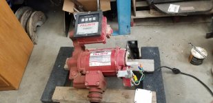

Testing a Fill Rite fuel pump
jocww
Nov 18, 2011
231
It should be ok mine is a aluminum impeller i think. if your really worried do it with water then do a couple of gallons of gas to flush it...

Provincial
Sep 21, 2011
6,874
Near Salem, OR
Once you fix the coupler, it still may disappoint you.
Those pumps won't put out near the "rated" GPM. It is kind of like "Detroit Horsepower" from my youth. I think the ratings come from 0 head (not having to pull the fuel up from below) and an unrestricted outlet. Pumping up from a tank and having hose/nozzle on the discharge greatly reduces the flow.
skippydoo
Oct 28, 2012
177
Sussex NJ
I would test with mineral spirts. Flow ratings with a register on it , maybe 15gpm using a non automatic nozzle.
