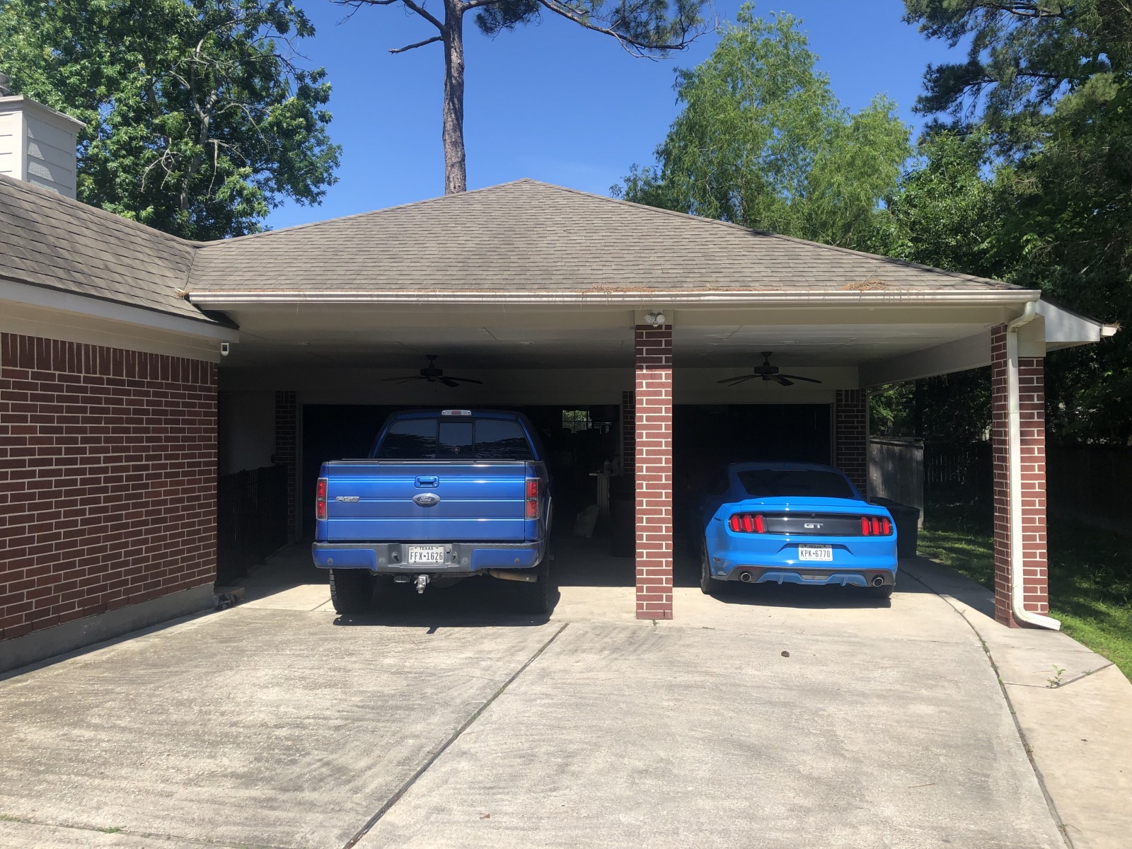

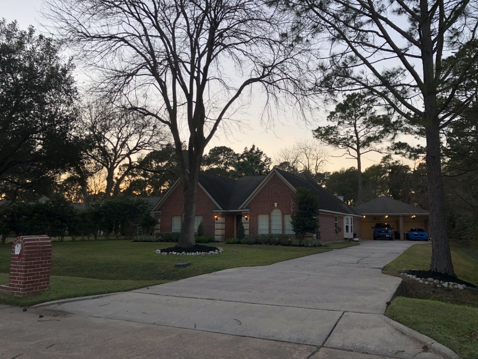

Last year, my wife and I moved into a new home. The previous car had a slight oversized 2 car that we had remodeled. Here is a little before and after of the first one:
The new house, has a little more property (little more than half an acre) and came with a 3-car garage with a car cover on the front.
One thing as this remodel was going to get underway was removal of the 3x large pines I have at the house. One 100+ ft pine is DIRECTLY behind the garage. The one near the front of the driveway is also destroying the concrete for the roots.
Better shot of the old truck and wife's car under the port de coche
Over time, I would like to extend further into the backyard as I can stretch the structure another 30' or so without any compromise to the yard.

Can you enclose the car cover area to enlarge the garage space that way?

We talked about that but honestly, I have enjoyed having that car cover WAY MORE than I ever thought I would. Plus it adds as the breezeway to my backyard and I do not want to stuff that up more. I have probably 50 or so feet behind my garage directly so if I need to move back, I can do that later.
In all honesty, I bet I am building a house 10 years from now and hoping these new additions allow me to reach that time point with ease.

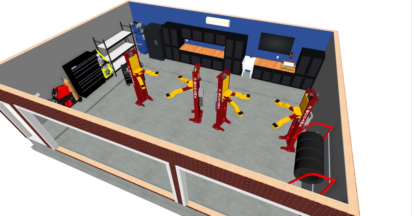

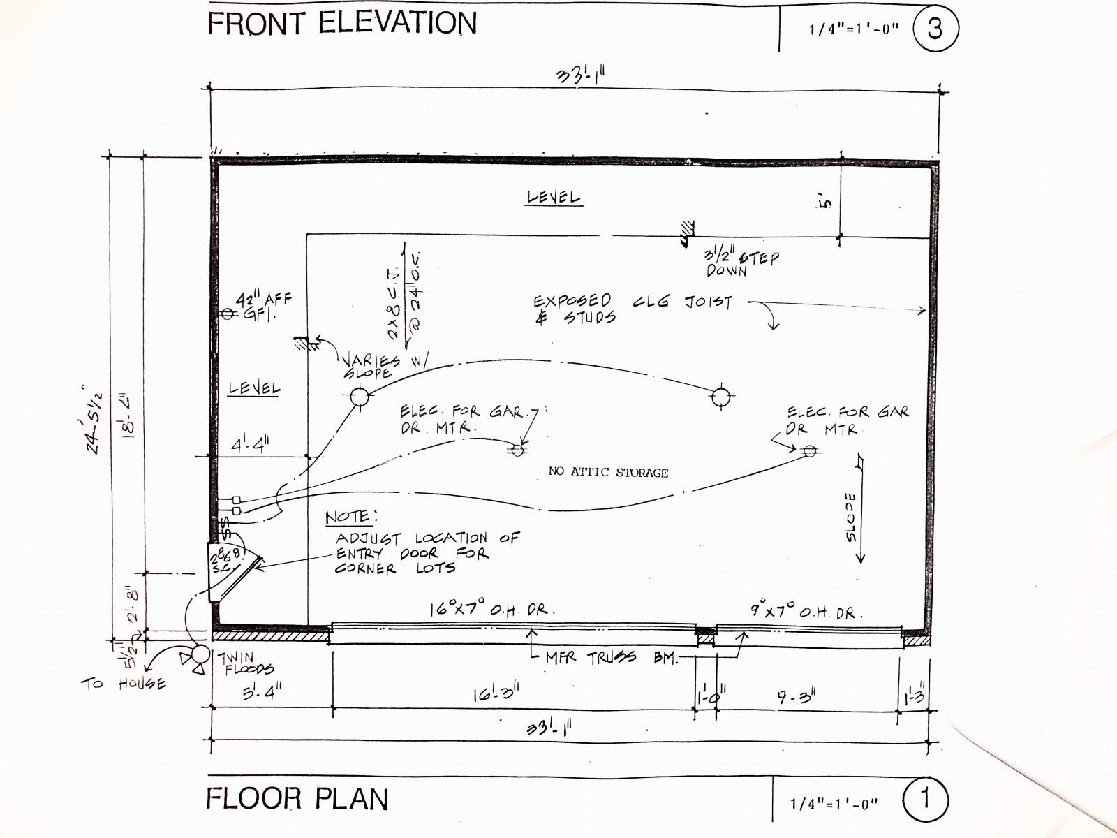

As for the current plan, this is what I had drawn up in my head:
First off, here is the base layout of the original garage. The original owners had a couple things different from the original drawing, but this is pretty close.
I did some checks (I am an engineer by trade) and worked some ideas out with my friend (licensed architect) to confirm how I can remove the joists to improve ceiling height. I worked with a family friend who constructs custom homes and worked a plan to remove the joists and "divider" wall in the garage. After getting the plan together, I made a model of what I would like the garage to look like. Have my paint choice and model below that I created.
Obviously, I like blue.... but the grey is a little darker than the color swatch shows.
In regards to the steel cabinets, I am not sure if I am running NewAge or Saber or doing a set of toolboxes with a row of cabinets above, but it will look something of the sort.
For decor, I have some stuff I have been working on. My father and grandfather are big into cars. When my grandfather passed, I ended up getting all of his Hot Rod and Motor Trend Magazines from 1954 - 1980. It has been fun finding all the old ads and articles. My wife and I may salvage some out of the few magazines in real rough shape and frame the ads for the garage. A small sample of what I am working with below:

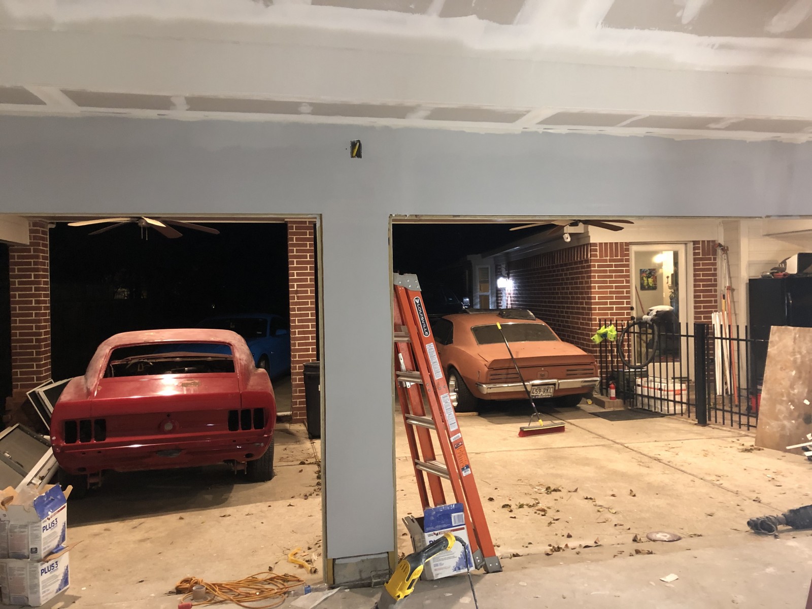

The work begins.... unloading the garage.
So with the work starting to shape up, I had a few big things to get going with the demo. I have a ton of old cabinets, a dividing wall between the single and double bay, and a **** show of electrical wires. Naturally, the panel is on the furthest wall away from the house, so all of the home run wires just run right across the top of the joists and into the attic space of the breezeway into the house.

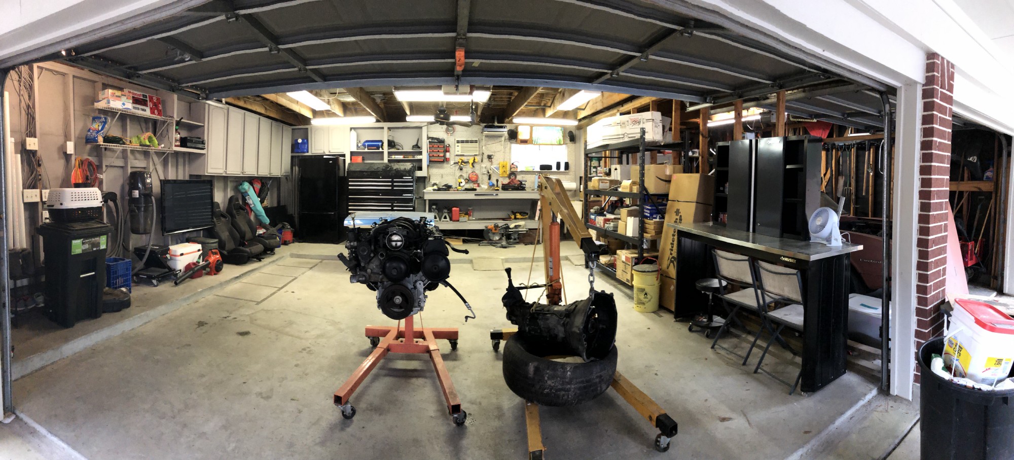

Here are a couple interior shots of the garage prior:

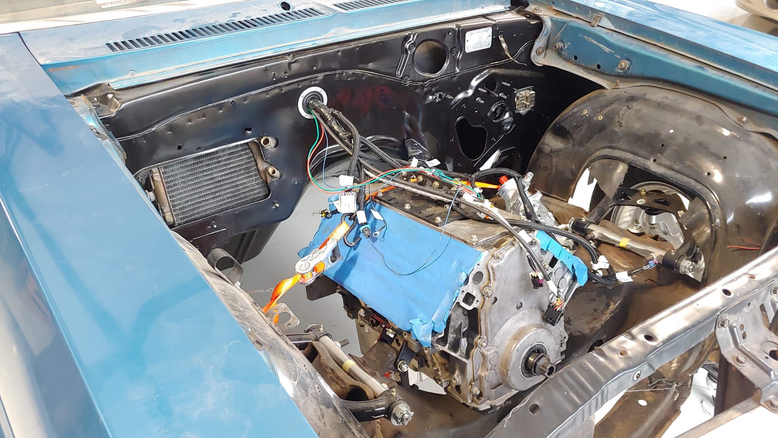

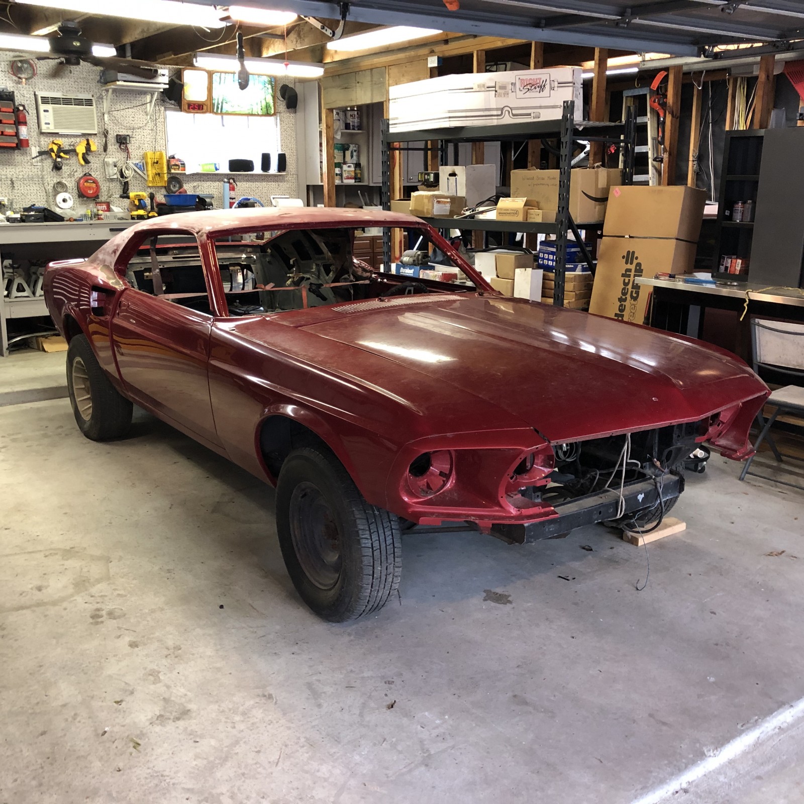

After I had taken this photo, I was preparing my Nova for it's LS + T-56 swap. I am fortunate some good friends of mine have a nice 50' x 50' shop in their backyard and they are literally 1 mile from my doorstep. I moved my Nova to their place and have been working on it after work and on weekends. Fire up is coming soon :D.
My other issue is that I am mental and picked up a shell of a 1969 sportsroof Mustang. It is a legit Mach 1, I have the vin, marti report, etc if anyone has interest to see it. Anyways, that is now in the way and sitting under my patio cover area next to my wifes 1968 Firebird.
In the evening, I got to work with my wife and we demoed all the cabinets and removed all of the equipment out of the garage.

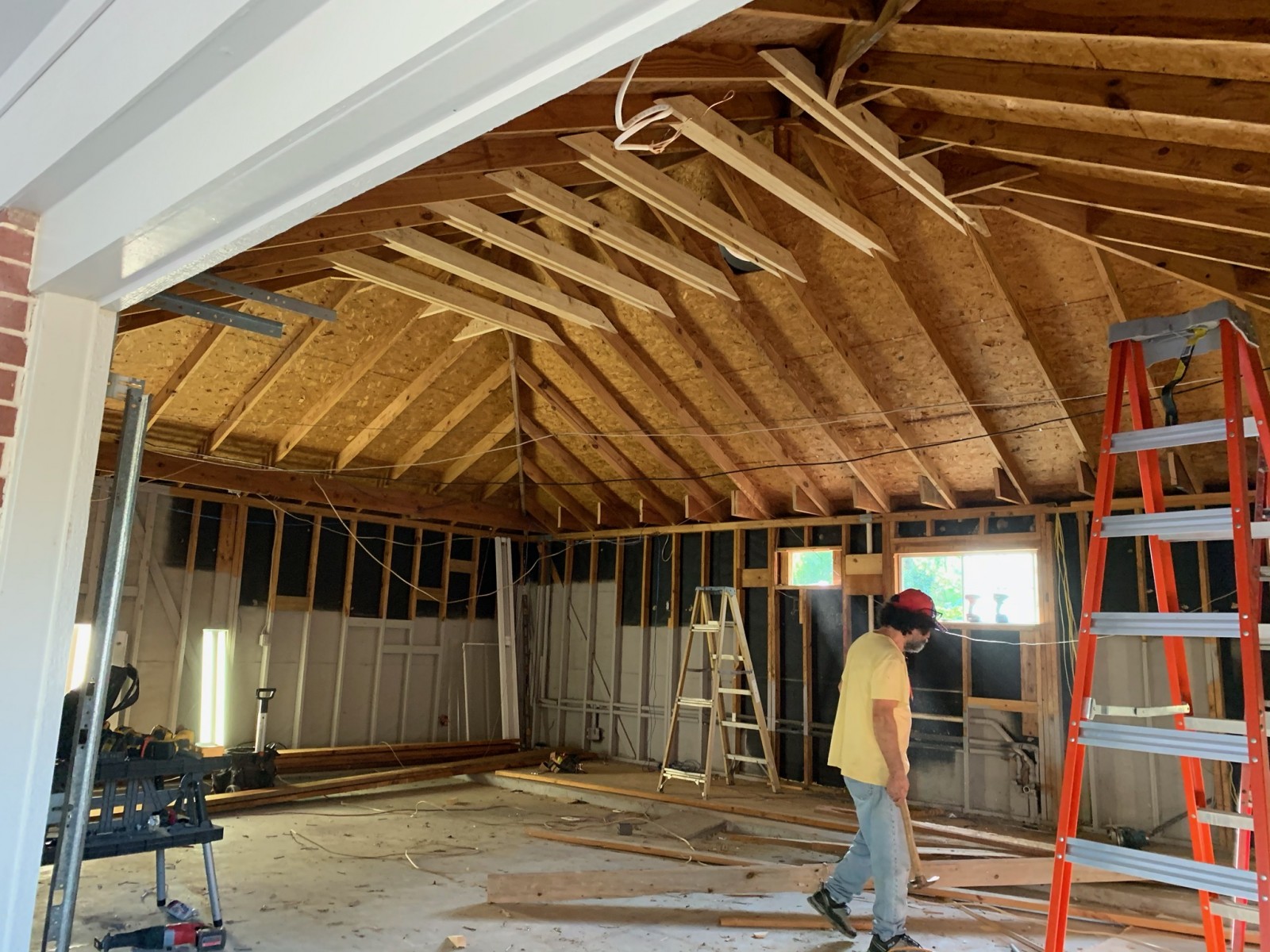

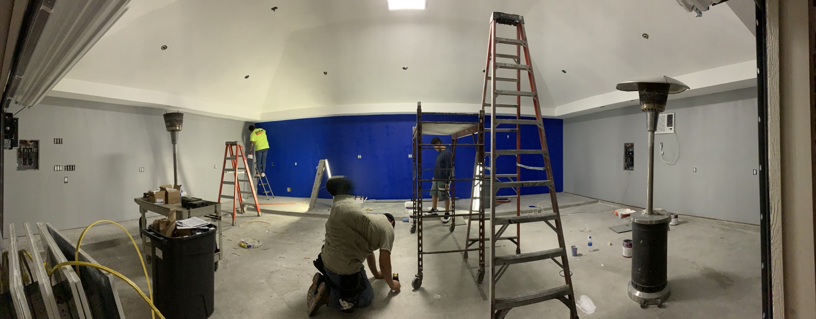

Construction Starts:
My father helps run a commercial/residential electric company. He has worked with all kinds of teams for small and large build outs. For me, he has good connections on craftsmen that can help me get this job done.
I must say, the guys move FAST. I was in the garage drilling holes and preparing for all of the electrical to be relocated. We pulled all the runs from the box, added a second panel and moved all electrical to the front of the garage where the port de corche is or around the back of the garage. We had some challenges, as I have a lot of pool equipment and other items. It results in me having a lot of switches in my garage, but I don't mind.

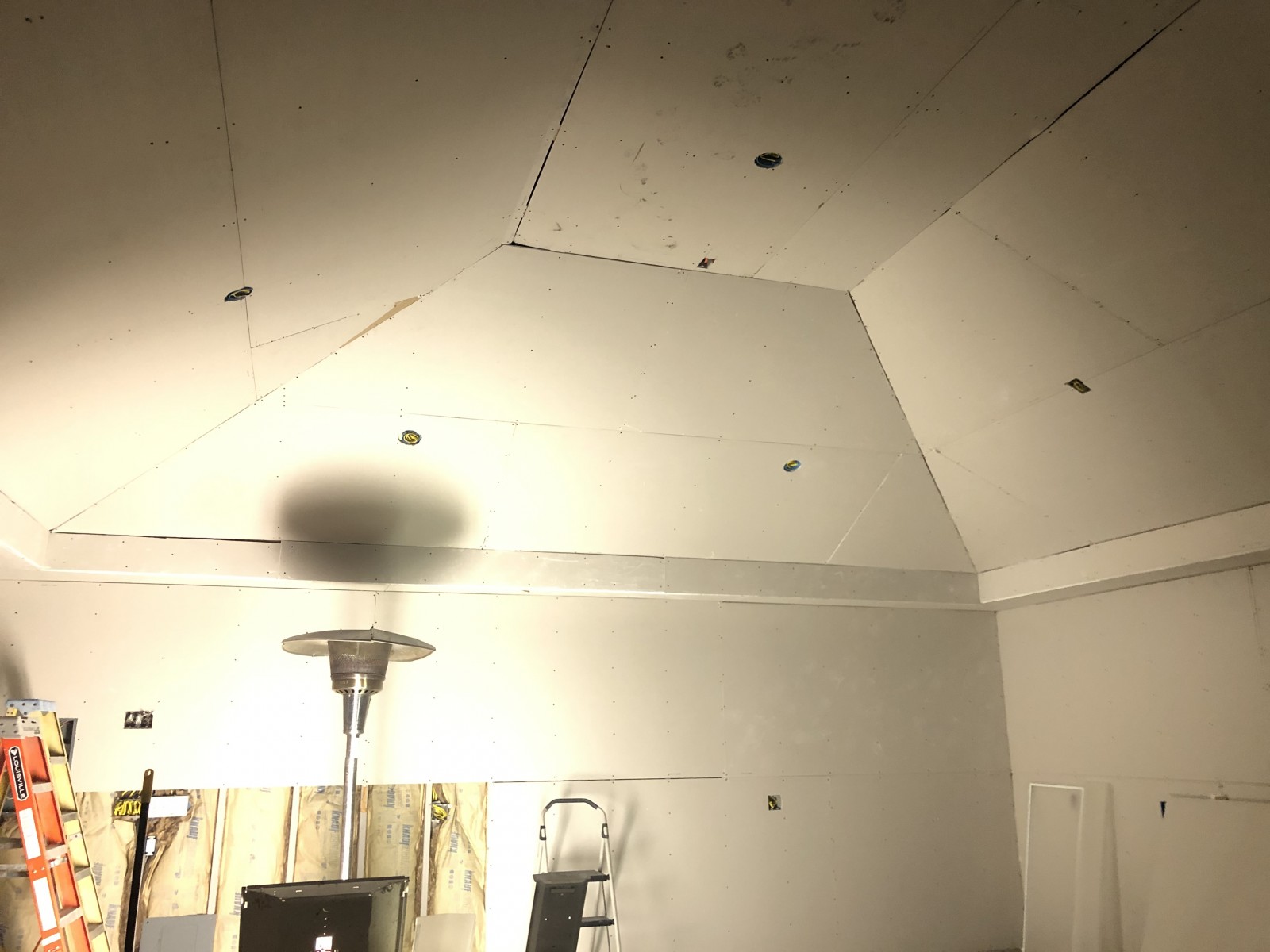

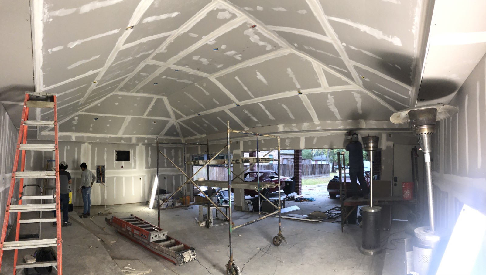

With electrical out of the way, the framers started their work adding structural support and wind blocks to the rafters.
Soon, insulation started going up and preparations for rock being installed were underway.
I have done my fair share of installing sheetrock and I will tell you, I cannot tape and float for the life of me. The pros that do it day in and day out are always worth the money for speed, quality and the final look. It has been cold in Texas lately and I had no garage doors so the crew brought some propane heaters to help with getting the mud to dry.

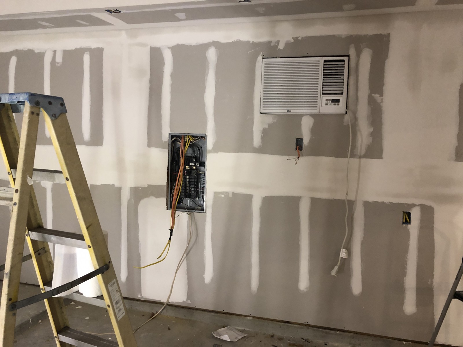

Here is a look at the wiring of the panels. Not completed but getting there:
As you can see, I have a large 240 LG window unit. Not my preference but was given to me by my Dad as he had one laying around. It is an 18,000 BTU unit for cooling and heat. It should do the job fine, but I have no issues covering it up later and changing to a mini-split if it does not perform like I would want it to. Will never complain with FREE though! :)

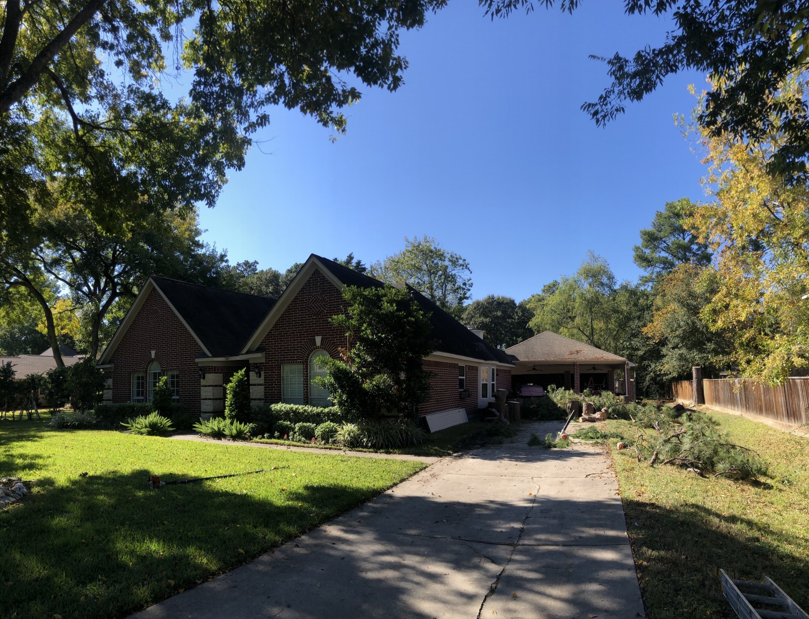

During the time that was happening in the garage, I had my three pine trees removed. Looking forward to not having a TON of pine needles everywhere or the risk of the tree behind the garage crashing through house...

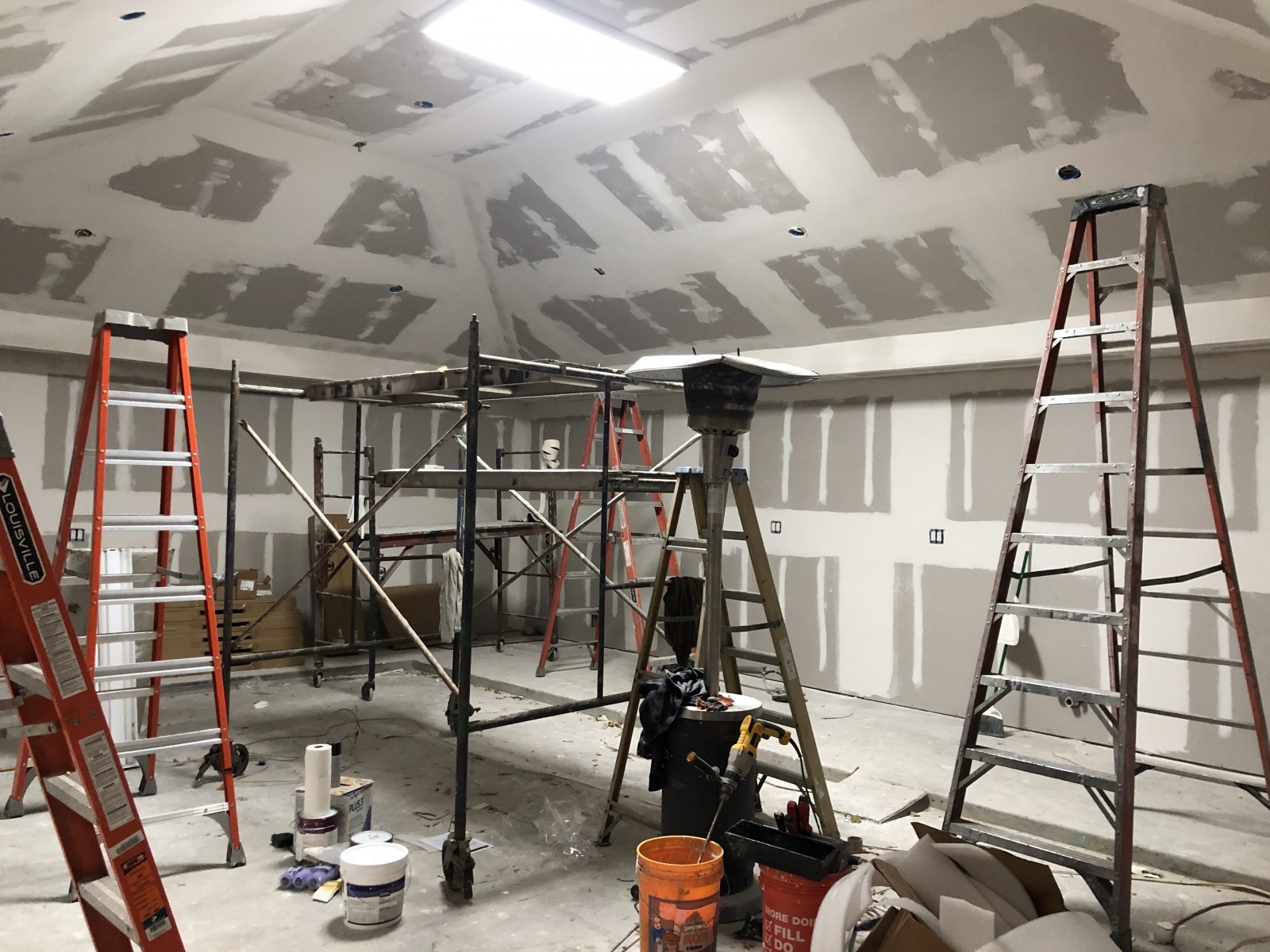

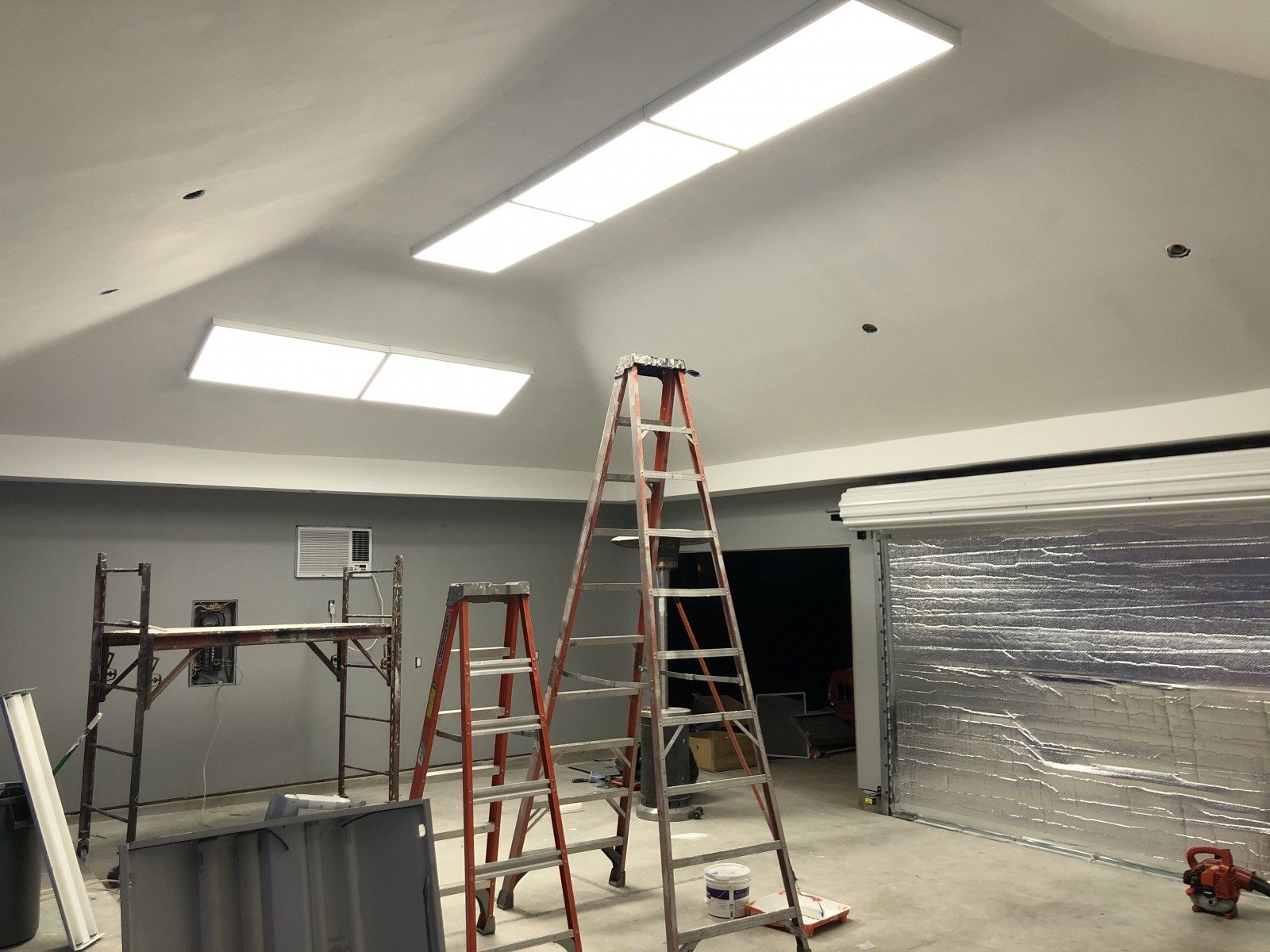

Where we are on the journey as of today:
Currently, the mud/float is drying. I am patiently waiting to get a little more time to dry before throwing the paint on the walls. I tested the gray on the wall where the garage doors will be hung and turned out pretty good.
:bowdown:

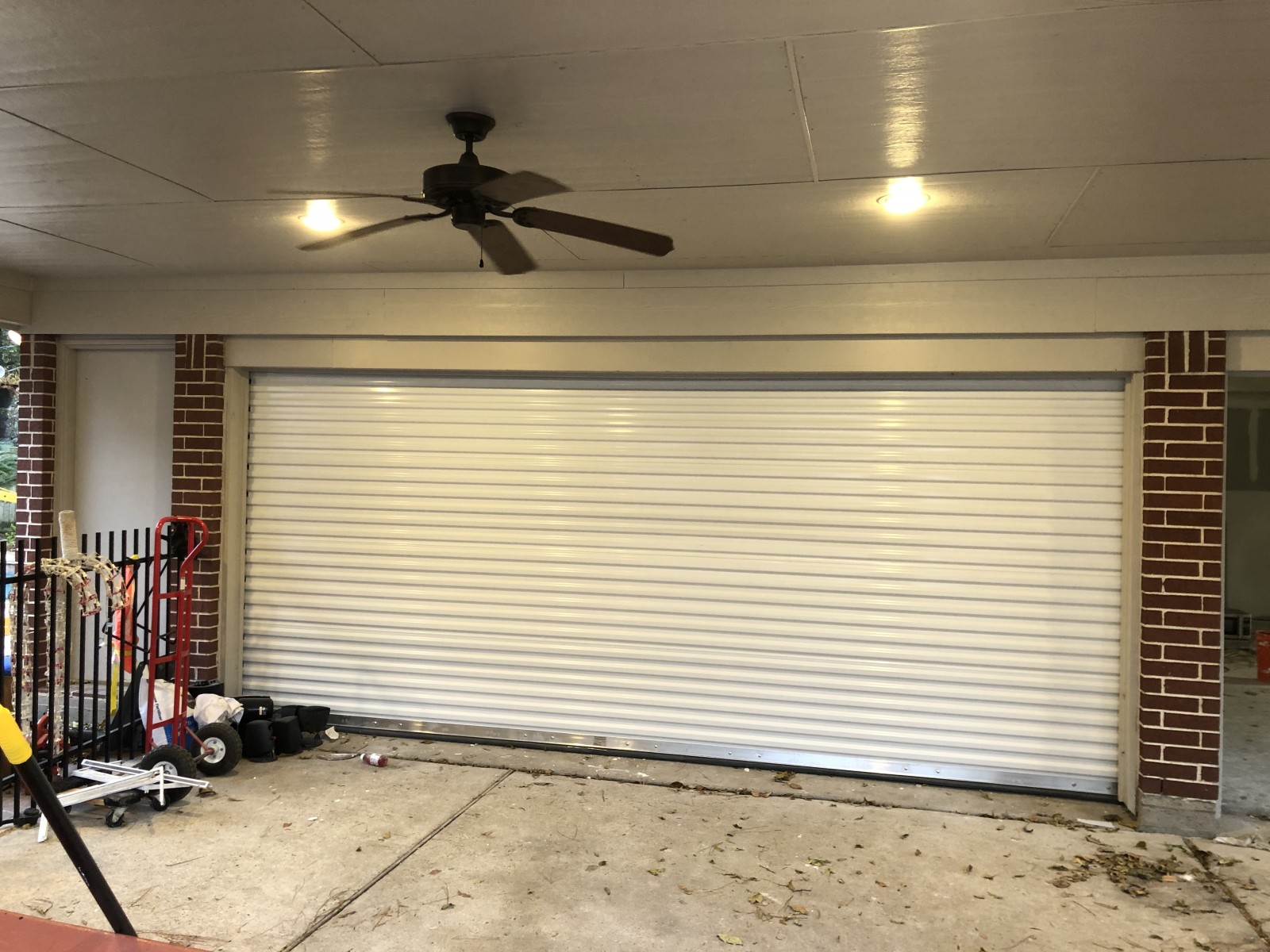

Yesterday, the roll-up garage doors were brought to be installed but one was manufactured too thin, so another door is being ordered and will be delivered next week.
With that being said, they turned out awesome. My door sizes are 16x7 and 9x7. I only plan on the 16' door being powered as the single-car slot is more for storage and whatnot. That will be easy to roll up manually when I need to pull a car out from that side.
The liftmaster is very quiet. There is a little bit of noise in the background bt you will get the point. Had my wife do the honors of opening the door for the first time to check it's operation :lol_hitti

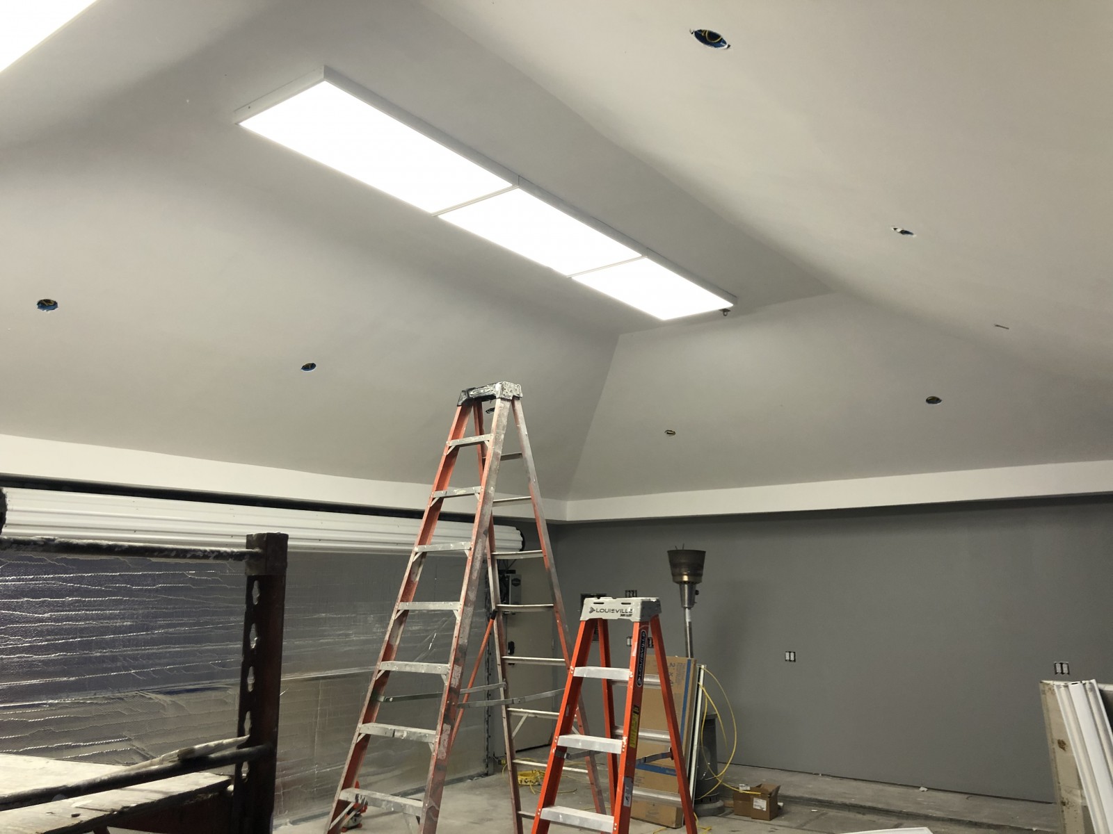

Last night, I was able to get all of the devices installed. 220 service for the air compressor, the AC unit, check the drops for the two lifts. Also installed all of the switches and plugs.
I also got all of my LED panels. These bad boys are going to be BRIGHT. I have the ceiling wired up on three switches as LED's don't play too well with dimmers.
One switch is a horseshoe that will light three walls up. The second switch is the ceiling directly at the top/center of the garage. The third switch will be the two lights for the single-car bay in the garage.
For painting and testing purposes, only one LED setup was installed in the garage. Needless to say, I may need sunglasses in here when it is all said and done! :shocking: :pimpflash

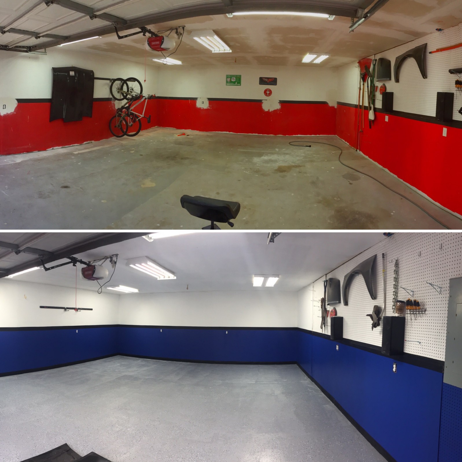

2nd Coat on the walls here:
Next big items is the 2nd door getting delivered and installed tomorrow. I have also pulled the trigger to get my floors coated as well.
I have also re-hosted all of the photos and hopefully those work now as well.

That ceiling is awesome! Are you going to wiring in a new plug for the liftmaster?
Thanks. I have a dedicated plug right above the liftmaster that it is plugged into now.
I also have my 2x 220 drops in the ceiling for the lifts. Will use conduit and hard wire those up.

So, the past week I was out in Iceland. What a sight. I would highly suggest anyone to go check it out.
Couple photos from there.
Northern Lights!
Ice Cave at the Glacier Vatnajokoll
During the time I was gone, my parents were able to check in on my house as I was having the floors coated. (Please don't bash me on the quality of the photos lol)
Basecoat done!
A couple of coats with clear/specs completed.
Overall, I am pretty pumped up. Ordered cabinets, and some other items for the garage. Hope to get them in a week or so. Time to start putting items back into the garage now. :)

Thanks! Got some cabinets on order and some more shelves. Going to start throwing stuff back in there this weekend.
B
BigBronco
Aug 17, 2013
44
Houston, TX
Nice looking build! what cabinets did you order?
Funny enough, Home Depot had a killer deal on their heavy gauge husky cabinets (all black with anodized black handles)
I got a few components this weekend and will be installing/hanging the wall cabinets this week. I need to pick up the air compressor (currently at my brothers) and get that moved over.
Things are moving along. Hopefully, in the next month or so, I will order the lifts.
