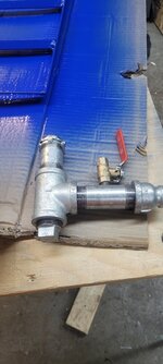

I have this Black Bull gravity fed blaster, and it's an absolute turd. Can never get this thing to work right, just blows air with little to no media coming out of the gun. I always blast with play sand (yes I know about Silica- and yes I wear a mask) :deadhorse At first I thought the sand was wet or something was clogged, but I can't find anything of the sort that would impede its function. One of the worst tool purchases I've made. Think back when I bought it - its rating was 4 out of 5 stars. Now you look them up and it's a solid 3 out of 5 stars.
We learn as we go. Probably back in about 1980 my first 'outside pot' blaster was a DIY gravity feed 'turd'. Powered with 2 Bendix-Wabco truck air brake compressors run off of an old 16hp garden tractor. I had about 18? CFM and thought I was all set. Nope! Next step, a 1940's IR 105 CFM portable and DIY pressure pot made from an old forklift propane tank. Much better. I was all set to blast wheels and car frames in the July heat. Fun for a little while....
That style abrasive discharge will never make it, as it is like sucking sand through a straw. You need a T under there as a mixing valve. The object is to have an air flow cross ways through the T underneath, then dribble abrasive into it to maintain a steady grit flow. Whatever it takes to make that happen is the process. A ball valve between the tank and the T can act as a grit flow regulator. Look at pictures of more substantial blast pots for 02BAADD6-A70A-417C-A6E9-D7E7BEE6A6E4.jpegideas.
