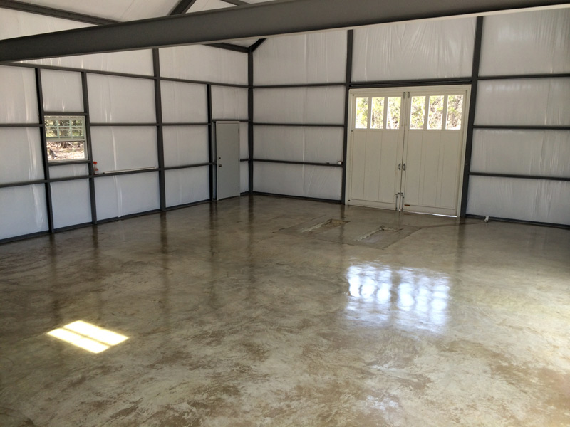

Well, I got busy over the holidays, trenched 75' of rock, got power to the building, and finished the wiring... Here's where I stand now:
Not sure what I'm going to do next... I still need to build a welding table, wire the compressor, run air lines, install the lift, move-in, etc...

I see in your third picture you have the mez up with beam. So to finish up the beam thread, how did you solve the sagging beam?
lg
no neat sig line
As it turns out, there was no sag... It was just the floor... I've never been happier with my ****** concrete guy! :)
Ryan, can you elaborate on the "no sag" issue ? Was something not put in level ? I was curious too as to how the issue was solved but failed to check back in.
R
Ryan
Administrator
Jan 26, 2006
5,690
Texas/Hawaii
Essentially, the problem wasn't solved really... As it turns out, there was no problem. The beam wasn't sagging. The measurement at the center of the beam was shorter than at the edges because of a low spot in the concrete.
I've currently got around 2000 pounds up there now and the beam hasn't deflected at all. I've measured this with a string pulled taught across the top of the beam. Oddly, the beam is actually bowed up a tiny bit.
It looks like it's sagging in the picture above because of the wide angle lens on my iPhone.

I haven't read about your initial build so was wondering what type/manf. steel building is that. Looks better than the carports but not as industrial as the red oxide post and purlin buildings.
Ahh, that makes sense. Concrete floor and not the mezzanine floor. :thumbup:
I'd guess the slight "up" bow is pre-stress that will flatten out with weight induced up there.
