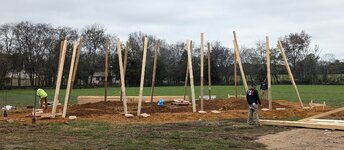

Now for some posts, these are three ply laminated posts. 3 - 2x6's glued together. The lengths are finger jointed together, the bottom 1/3 or so being treated and the top portion non treated. They are planed after lamination and are straight as an arrow. Much better than a treated 6 x 6 that will twist like a pretzel.PXL_20241108_180144538.jpg

Looking great, Dan!
I bet Joy's chili and cornbread were fantastic and appreciated!
They were, they cleaned out the Chili! The cornbread was perfect! They thanked us several times! We love to share food with folks, it just seems like the right thing to do. They are working hard and are far from home, no time to really enjoy lunch if they have to grab fast food. It's the simple things that bring joy to our lives :)

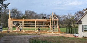

4 -1/2 days since holes went in the ground and the shell is almost done. Rain just started, I hope they can finish today. They have a 2-1/2 hour drive each way. It would be a shame to drive all that way to complete another hours worth of work.
Someone will be coming back as they still have to do gutters and down spouts.

Looks great. When I first started reading this thread the photos reminded me of some other build and I thought "Oh I've read this old thread before." Then I saw the date it was posted and was happy. Another new build to follow!

You know what? I just realized due to your comment how similar this looks to my old shop rebuild. I will sincerely state, this was not intentional. But none the less, here we are. It would appear there are some colors that just happen to work for me :)
OMG, the old shop from 2015, 30' x 40' : 20151105_063206.jpg
