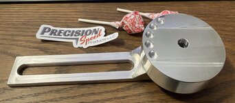

Here's a few
Supercharger belt auto tensioner mount, 3D printing helped me to get it all fabbed up before having it machined out of 6061
Sonic cup holders for my 95 Lightning :)
SBF timing cover seal installer
The list goes on, but you get the point :) Just buy one!
ON EDIT:
Forgot to mention, it really helped me in designing a motor plate for my project truck. Obviously I could not print the whole item, but I was able to print sections to get the measurements close then I had Send Cut Send make the whole part out of cheap acrylic and from there I was able to further get the dimensions in place, once it's right I'll have it made from 6061.
