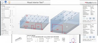

So I am ready to pull the trigger on ordering lights.
I think I am going to go with these lights for the dimmable feature:
https://www.ledlightingwholesaleinc.com/E5SLB35D4-850-p/e5slb35d4-850.htm
Below is what I feel is a reasonable compromise in number of fixtures and fc for my purposes - being part gym, part quad/toy storage and working bay.
I also figure the splitting the garage lighting into 3 switches - gym area, center bay and lift bay. Lighting might be a little strong on the gym side but I plan on doing dimmers. Can't believe I am looking at 30 lights!!!
The bay is the 12ft wall section that has an internal 4/12 pitch that I need to account for - maybe add a couple side lights?
What do you all think? I feel like I could analyze this for every and really don't want to do it again...

So is there a recommended orientation of the 4' LED lights for a lift bay? (Right image in pic)
As you can see from the tool they have them lengthwise front to back and 12 lights (based on a flat ceiling but I have a 4/12 interior pitch). This will give me 86 fc and with the door open, only the center 1 (maybe 2) will be covered.
Just wondering if having them widthwise would be better?

Since I like doors up when possible, I installed my lights just outside the outer tracks, closer to the walls than is ideal. For the middle, where the 2 doors are only about 1’ apart, I hung the light between the inner tracks for the doors. I also hung these lights so they dropped down just below the tracks. My other lights are mounted to the ceiling.
In the rear, I have a row that is perpendicular. I do more automotive work in the rear. I could have tucked a row across the very front but did not see the need. Not good photos but you get the idea. 24x30 with 9.5’ ceilings (12.5’ over lift) and 6x15 bumpout on one side.

How over lit will it be at 4x8. I break down the shop by 20x25 bays. So I was thinking of the 4 lights per bay. Rarely will they all be on at the same time. I tried to convert the file you included and came to the conclusion i am lame.
Thanks
Chuck
Using 70|50|20 Ceiling|Wall|Floor reflectance 4x8 = 120fc @ 30" work plane
Using 20|20|20 ... = 105fc ...
70|50|20 = Ceiling painted flat white|Walls painted eggshell white|concrete floor
20|20|20 = Bare wood ceiling and walls
Steel structure would be somewhere in between the 2.
Pitched ceilings require more trial and error testing per situation. There's no simple rule that I can apply. Space needs to be modeled in Dialux to be sure.

Platonic Solid thanks for the calcs. I have the white ceiling, but not the painted walls. These are fixtures that can be dimmed if I am over whelmed by the light.
I will follow up once I have them up.
Thank You for the help
Chuck
