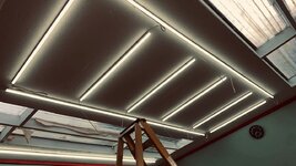

I ended up buying the Barrina LED 4ft lights
I ended up fitting 8 of these LED’s above my workbench
And 18 on the ceiling
12 in the middle section of the ceiling and 3 each at the end sides of the skylights, I’ve only had these fitted a few months back so can comment on durability but I’m very pleased with the light output they give
