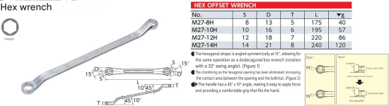

Have you bought special variants of non-bike tools to deal with bike problem scenarios?
My e-bike's chainring has a 10mm nut (external hex). It's recessed into a hole, only protruding ~1mm out of it. The gap between this and the frame in the most favourable rotation position is ~15mm. I'll get them off one way or another possibly by jamming them in the hole, but I took the excuse to find some tools that may help with this or something else in future.
KTC M27 offset double ring end wrench, with no chamfering, and rotationally offset heads too.
Are the KTC wrenches the solution to your chainring, or are they on their way to you?
Do you know what the OEM tool is?
They're on their way from Japan with some other stuff, so will be a while. But yes, that's what I got them for, although it's at least possible to retighten loose ones with an open end wrench put on at an angle (not ring ends due to the chamfer).
I was wondering if chamferless wrenches existed and found this post on here about them. I know flat/chamferless sockets are available in larger sizes for suspension stuff, and of course you can always grind stuff down.
I don't know how these ended up on my bike. eThirteen crankset with SRAM chainring, so blame one of them. I had the bike shop fit a smaller chainring (also SRAM) from new, and the empty box for it I got contained normal chainring bolts/nuts.
Come think of it, the bike shop probably used one of these cut stamped chainring bolt spanners which suits all types, and has no chamfer. Never had a bike with chainring bolts before, so didn't remember these things existed. The KTCs will be nice to have anyway and they were cheap.
(not my photo - source)

the steel just seems too soft
I believe they're all stamped out of steel rather than forged.
There are thin normal wrenches out there, for example the Facom 31 double open end in 14x15mm is 3.6mm thick. Still almost twice as thick as a cone wrench.
