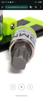

What's the difference between RBRT and RPT? A search did not find anything useful.
It looks like RBRT's twisted design would tend to cam out when tightening. Can RPT tighten? Can those replace hex socket sets for regular use?
Twisted version is available from Ingersoll Rand and others.
Here's RPT from Grip Edge and RBRT from Mac.

^ pretty sure the difference is only branding.
Following link - cites they white label for Mac:
Would note this just applies to bits and extractors. Mac wrenches with rbrt am pretty sure is Facom/SBD derived design.

When I searched for RBRT I found a lot like these: 575_rail_27f69876-6114-4986-8143-893d2d2cae97_700x.jpg
But looking more I see that's not actually RBRT, and those are straight. Never mind, my question was ignorant.
