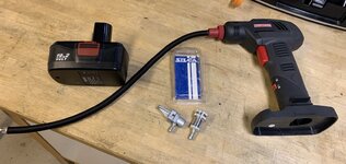

I used the old craftsman exclusively for dialing in cyclocross tubular pressures.
Accuracy Test: 55.5 PSI on the Craftsman reads 55psi on my Topeak digital checker. 30 PSI on the craftsman was 29 on the Topeak. I'm satisfied.
Total Cost Breakdown
Inflator + Charger: $68.00
Battery: $16.15
Presta Head: $35.50
Total: $117.65
Pics:
