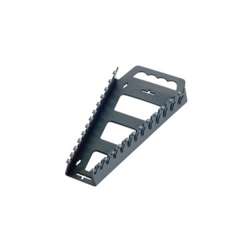

I also started organizing a little tonight.
I need to come up with something better for the wrenches.
Squankum
Mar 28, 2011
7,647
Southeast
Oh, yes. That is a serious lack of density with the wrenches there.
If you plan on picking up the whole set and carrying them across the shop or into the driveway, then the Ernst gripper kind is nice. I bought a bunch of them and eventually realized I didn't care too much about that option. They'd be nice for a wall mounting. They keep them secure, but on the other hand, I wouldn't carry the Ernst Gripper through the junkyard, either, that'd be a job for a tool roll.
I bought a set of Craftsman Professional wrenches on ebay and they came with a black SK rack that i do like a lot. They have better wrench density than the Enrnst gripper type.
Pictured below (grainy photos, like the sasquatch), on the left, various racks sold by SK, two of them looking very Ernsty, one like the one I wound up with. The other pic, the one i wound up with with that purchase, which they may not sell anymore.
The Ernst grippers do give you the option of setting the wrenches on top of the notches, for very fast access, or pushing them down into the soft grooves, depending on your transport needs, or the depth of your drawer.
You can paw the Ernsts at Northern Tool, last I looked.
You could also just build something with a back saw or coping saw and some bits o' wood.
