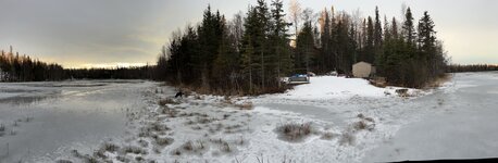

Some minor updates:
I did get the 12’ cantilever rack loaded before Winter was suddenly thrust upon us, but no roof yet. I’d like to HAVE a roof, but don’t yet WANT to build one, especially given how precarious/poor access/tractor won’t reach/I’m getting old/I don’t bounce well/ it is.
BUT; my only neighbor that direction has finally subdivided (after 40 years) and if I wanted to double my acreage and get yet more shoreline and an access road out the back and a couple flat acres on a platted cul de sac for a speculative house build, I could have even more places on which to stack treasures.
That fence on the right is off of my property, and is all that remains of a horse paddock last used in 1975. It’s a little overgrown now.

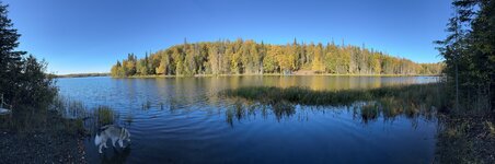

So you got that paperweight home. Any updates here? Did you splurge on some more acreage?
My 80yo out-of-state neighbor has just agreed to sell us half of the cove!
We will add the 800 feet of shoreline to the left of my little black dog.
I hope to add a gazebo surrounding a firepit where I am standing on the tip of this small peninsula, if the lake ever goes back down.
