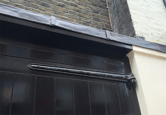

So I spent some time in London last week and ran into a bit of history while doing so... An English buddy of mine and I were standing outside a pub when I noticed a gorgeo...

Those certainly are some ornate, interesting hinges, Ryan. When designers think 'outside the box,' their work product can be incredible.

Very nice, however this design is not new (not that 1811 is exactly recent) .
There are many specimens that predate 1811 on New England Colonial-era homes.

This is GJ... who's going to make one with a nylon liner inside the joint, and a zerk fitting? And a flat roller bearing?

Based on the pictures, and not seeing them in person, I imagine they were originally designed to obviously allow the doors to swing, but also stiffen the doors for strength. The balled hinge pin sockets would provide a bearing surface and prevent the doors from being easily lifted out of place for security purposes. Today's older safe door hinges are similar and often have thrust bearings to facilitate operation while handling heavy loads.

Here's a place in merry-olde that will sell them to you. They sell them by the each, in lengths from 18 to 72 inches.
http://www.oakleafgates.co.uk/collinge-hinges/

Or buy a couple of automobile suspension ball-joints, and weld up some straps 'n' brackets. Worst part would be carving the tapers into the sections that receive the ball-joint stud. Tack-weld the stud nut for security--or not. You could probably rely on Loctite, and the natural holding power of the tapered stud. Thieves aren't that clever.

These are pintle and gudgeon hinges from Tractor Supply I used on my carriage doors:
http://www.tractorsupply.com/tsc/product/national-hardware-294bc-16-strap-hinge-zinc
View media item 12789
View media item 30926
They are certainly not in the same league as the Collinge hinges, but not as expensive, and very durable.
I don't know why someone couldn't make top-notch hardware without the insane prices that hardware gets these days.
The Collinge hinge is great, but I think a fixed pin hinge with ball bearing thrust bearings is probably the best thing for a heavy door. That requires technology much more advanced than was available back then, the Collinge was easy to do with sand casting and minor (machining?) cleanup work.
