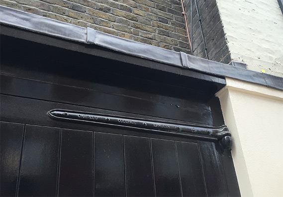

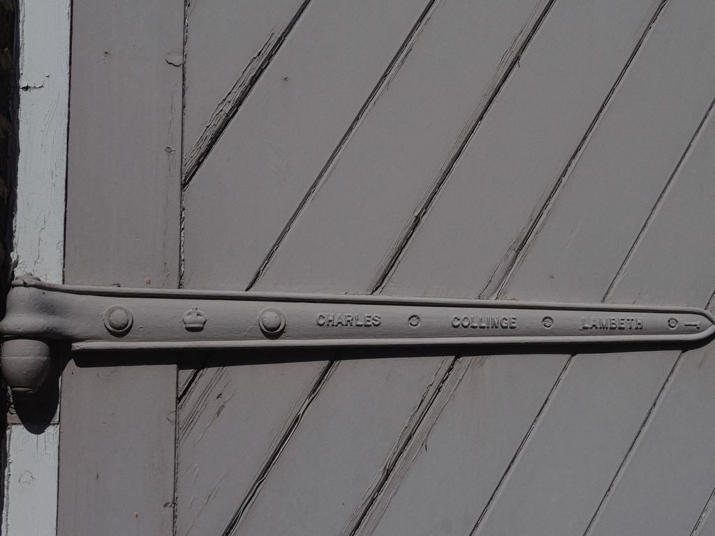

So I spent some time in London last week and ran into a bit of history while doing so… An English buddy of mine and I were standing outside a pub when I noticed a gorgeous set of old carriage doors on the building. What struck me most was the hinges… I asked my buddy about them and a history lesson began.
Charles Collinge hinges were first manufactured and sold in 1811.  They were  sand casted out of iron and featured a ball and socket design that could  support an incredible amount of weight despite their relatively short span. It’s a design that is so damned effective that they are still being made (with only slight design modifications) to this day.
And, they are absolutely gorgeous…

Very nice, however this design is not new (not that 1811 is exactly recent) .
There are many specimens that predate 1811 on New England Colonial-era homes.

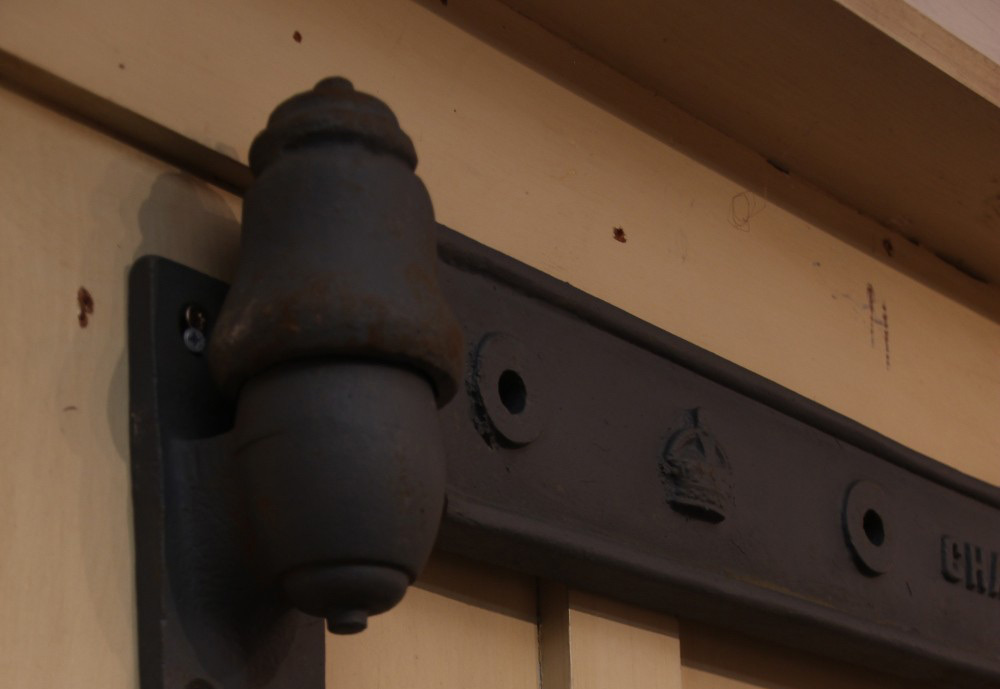

Based on the pictures, and not seeing them in person, I imagine they were originally designed to obviously allow the doors to swing, but also stiffen the doors for strength. The balled hinge pin sockets would provide a bearing surface and prevent the doors from being easily lifted out of place for security purposes. Today's older safe door hinges are similar and often have thrust bearings to facilitate operation while handling heavy loads.

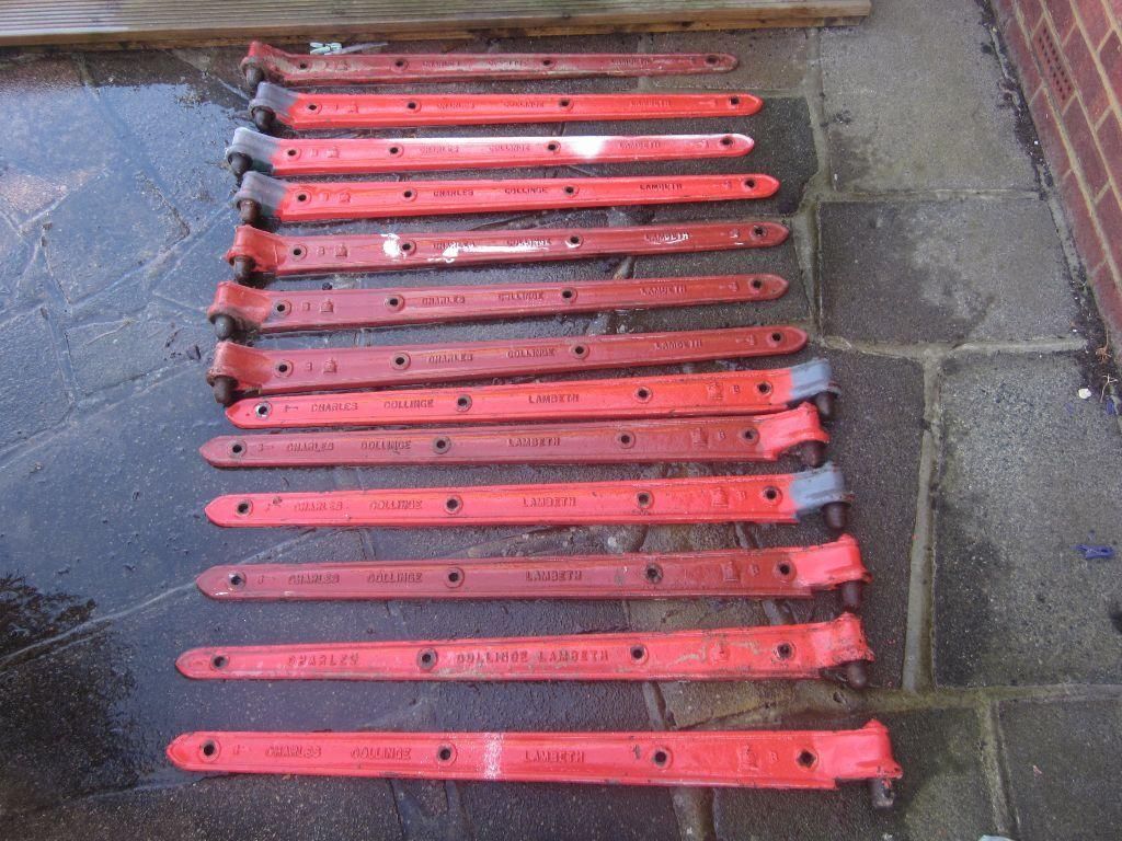

Here's a place in merry-olde that will sell them to you. They sell them by the each, in lengths from 18 to 72 inches.
http://www.oakleafgates.co.uk/collinge-hinges/
Schurkey
Oct 27, 2011
2,383
Or buy a couple of automobile suspension ball-joints, and weld up some straps 'n' brackets. Worst part would be carving the tapers into the sections that receive the ball-joint stud. Tack-weld the stud nut for security--or not. You could probably rely on Loctite, and the natural holding power of the tapered stud. Thieves aren't that clever.

The Collinge hinge is great, but I think a fixed pin hinge with ball bearing thrust bearings is probably the best thing for a heavy door. That requires technology much more advanced than was available back then, the Collinge was easy to do with sand casting and minor (machining?) cleanup work.
