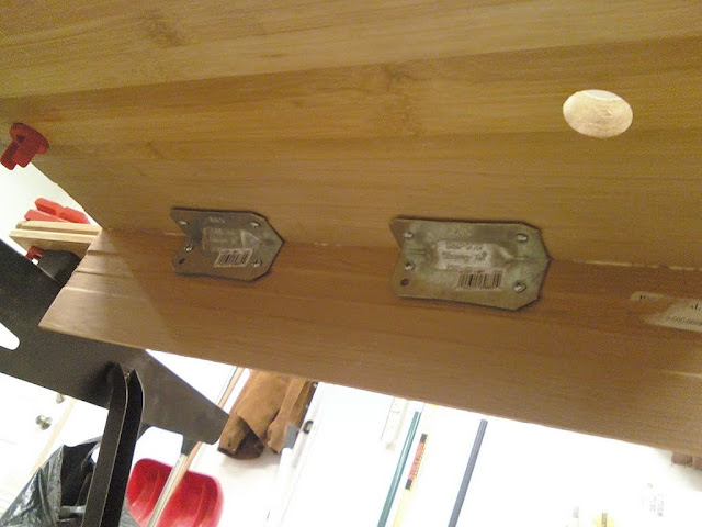

I've also added another latch to lock the wheel assembly in its up position to stabilize the wheel.

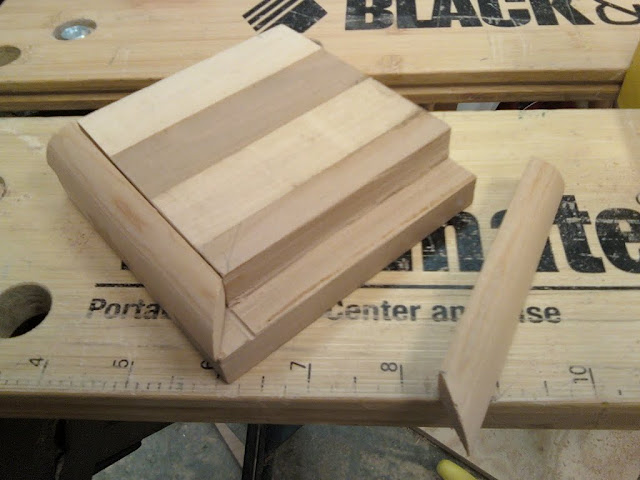

Building the feet for table was probably more involved than it needed to be. Sourcing a piece of 1' thick material was more difficult than anticipated, so I ended up with piecing together cut down 1" square dowels!
Lack of the proper tools for the project leads to improvisation
Yes, a router is on my shopping list. It just wasn't in the budget this time.
The extension on the upper left foot is to engage a support underneath the seat. (the quarter-round board here) Slider feet for the movable part of the table are mocked up here as well.
