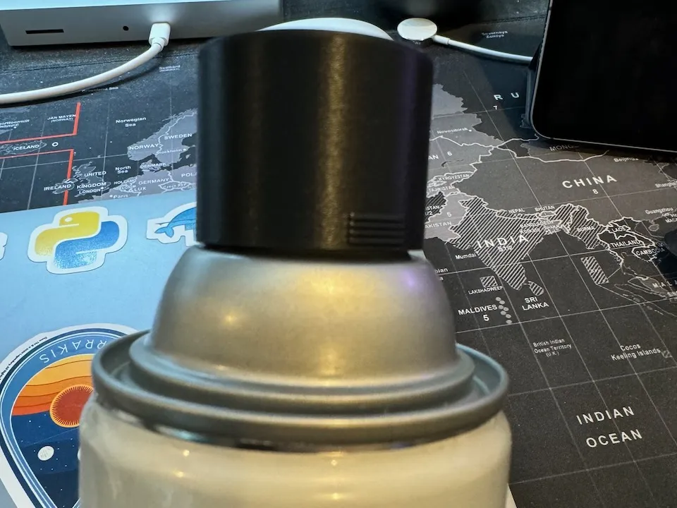

I almost said something about printing caps in your thread! But I didn't want to nit-pick
Ha! I also need to make some that are angle cut - same tune but a 15* angle. Haven’t figured out how to do them in fusion yet. “Taper” in extrude tapers both sides. I need more of a parallelogram.
