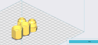

I've been working on a Case 448 restore which includes media blasting some hydraulic lines and a valve. The fittings are JIC and hard to mask off. I stole the 3D files for some caps and plugs off McMaster.com and printed some. Those went on the lines and the valve and stayed there from media blasting through finish paint.
man i cannot for the life of me get the caps to print good for JIC.
I'd be lying if I said I didn't run them through the 7/8-14 die and tap to clean up the thread just a bit. You also could try printing at a skewed proportion. Something like 97% in the X and Y but maintain 100% in the Z would make the plugs fit better. 103% in the X and Y with 100% in the Z should make the caps fit better. They don't have to have a hydraulic quality seal.
