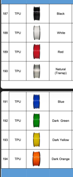

thanks for all the school house support.
Once I get the update catalog from the factory Ill post it up here to make sure in the next round we get better color options.
I'm working on multi color PETG.
and now silk metalitc TPU.
I wish I would have known about the school house stuff a month ago, would have saved me a bunch of money...next time.
draco_1967
Jan 3, 2021
217
Utah
Will you be stocking solid color TPU in the future too?
