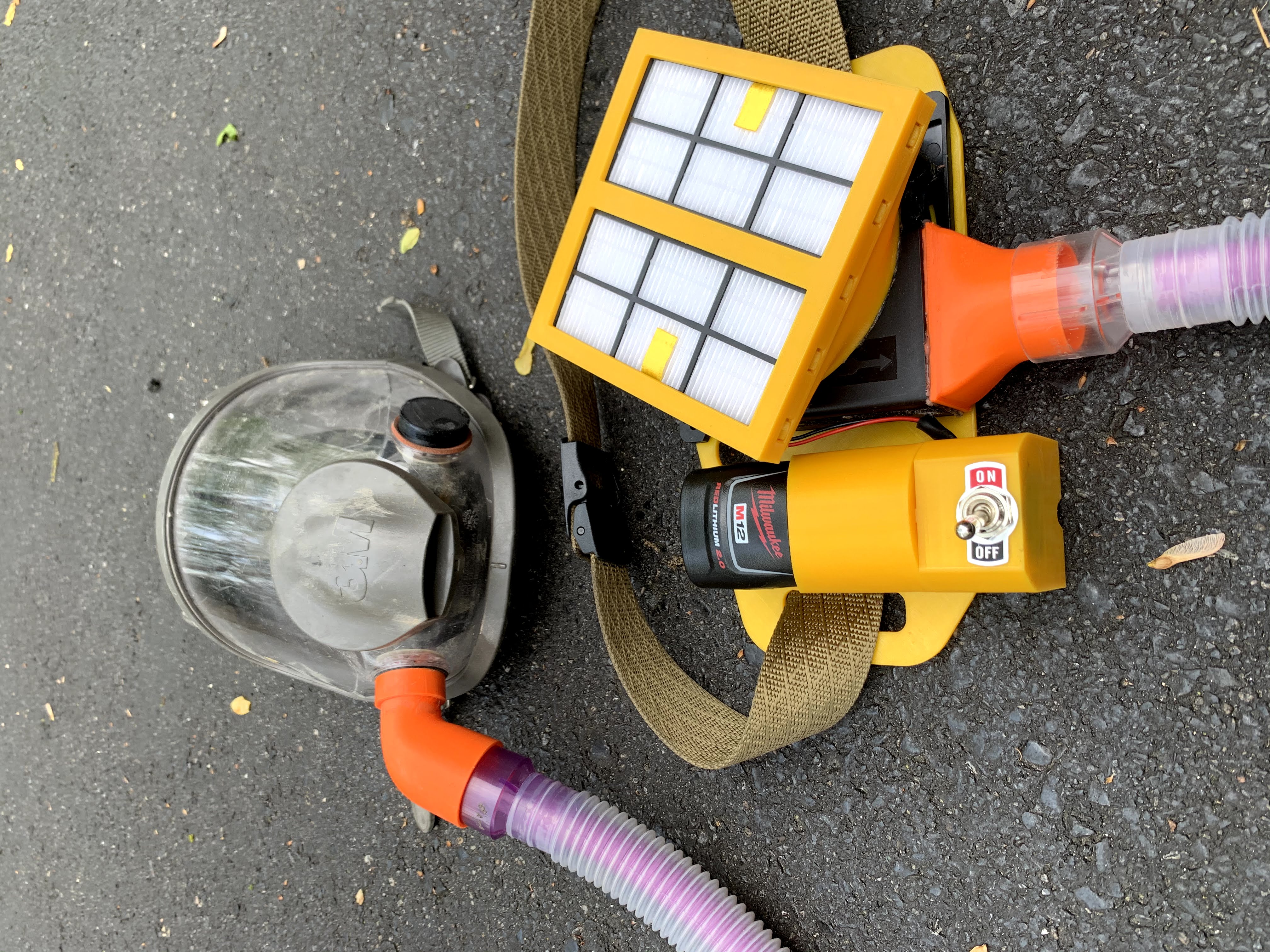

I've been using my i3 mk2s a good bit lately.
I made some cleats to hold my lathe toolholders:
A vacuum connection for the disc sander:
A light for the bench grinder:
And a PAPR for use around the shop:
Edit: hm, images with imgur links didn't work.

...And a PAPR for use around the shop:
That's pretty cool - is that something you came up with, or did you get the files from somewhere?
Thanks. I started with my own design using a smaller fan and 3M filters, here. Then I saw someone else's similar project, and modified my own for version 2 to use Milwaukee batteries and a larger fan; I kept an option to use 3M filters or to use Roomba HEPA filters (which are a lot more available and cheaper these days). In use around the shop, the HEPA filters seem to work very well. All the parts are my own design in Fusion 360. It could use some more detail work, and revision to use easily available tubing (I used some anesthesia tubing I had laying around).
