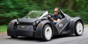

Maybe one of you guys could whip me up a Strati Roadster. Oh never mind the Strati and make me one of these.

Never thought about it but maybe you have never heard of the Strati. Well the body has been printed and the power side is electric.

In April 2014, Local Motors organized the 3D Printed Car Design Challenge crowdsourcing to assist in the production of a full-body 3D-printed car. Seven finalists were selected from more than 200 submissions. In June 2014, Local Motors announced that the challenge was won by Michele Anoé of Italy, who was awarded the $5,000 prize.[5] After the contest, Local Motors took the design and made several modifications so that the car could be manufactured through 3D-Printing.
Specifications Edit
The two-seat Strati is considered to be a "neighborhood" electric car. Depending on the configuration of the battery packs, the range of the car can be 100 to 120 mi (160 to 190 km) with top speeds of 40 mph (64 km/h). The car is not designed to be used on highways, as it does not meet the required safety test requirements. Production is planned by the end of 2015, with prices between $18,000 and $30,000.[6]
Front view with steering details exposed
Passenger side
Rear view
Manufacturing Edit
Details of the printed body of a Strati[7]
Following the design competition, Local Motors handed off the design to the engineers at ORNL who perfected the process of Large Scale 3D Printing such that the Local Motors design could actually be manufactured. ORNL worked with Cincinnati Incorporated to develop the printer that would allow for the printing of the entire car. With the printer, ORNL and Cincinnati Inc. manufactured all body parts of the car and allowed for easy mounting of the mechanical parts, such as the electric motors and batteries.
Strati is printed from thermoplastic using a big area additive manufacturing (BAAM)[8] machine (a large FDM 3D-printer). This material is fully recyclable, which can be chopped and reprocessed to be used in printing another car. After the car is printed, the mechanical and electrical parts such as battery, motors, and suspension are manually assembled.[6]
The printing process has been improved by ORNL since July 2014, bringing the printing time of 140 hours down to less than 45 hours in September. Since IMTS, ORNL has brought the printing time of the Strati to less than 24 hours and is continuing their research efforts with the hope of printing the car in less than 10 hours.
