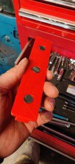

One of my goals for this year is to utilize my 3d printer more so I decided to replace my old foam extension holders with something a little better. Put some magnets in the base to hold it down in the tool box and with the stock HF liner they are about perfect.
