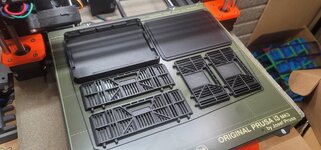

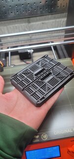

On the 3v2 bed tonight, I have pegboard hooks. Surprised that the 15% infill seems decently strong, not that I'm putting a huge amount of weight on them.
